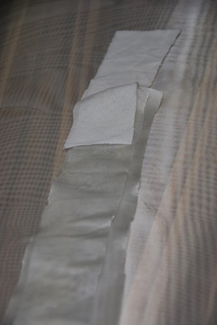

So here's the entire hull draped with 1 1/2 layers of 4 oz cloth. You'll also notice some precut strips laying on top. Those are the bias cut strips of 4 oz fiberglass cloth and the bias cut strips of Dynel cloth. The stips are cut on the bias (weave at 45 degrees to the strip) so that they conform nicely to the compound curves around the stems.
What's that? You need to see those strips from a closer view too!? Ok...
