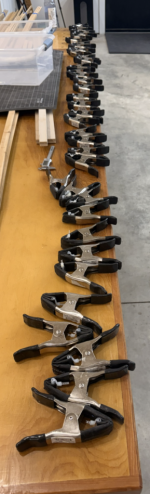

Here is a huge thanks to "jimmy clamps" and a picture of the pile strips under her veil.
Thanks!

Glad you like the Jimmie clamps ! They make assembling the hull easy, especially if you are going the stapleless route !
Anxious to see your results !

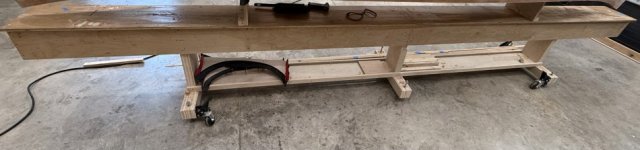

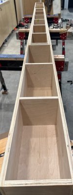

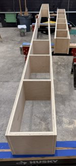

StrongBack and Lofting:
I used 18mm Cabinet grade hardwood plywood for both. I like the material, I have used it a fair bit over the last few years and I find the waste pieces can be useful. I also wanted to have station molds that I could reuse, screw into, machine easily, etc. Same goes for the strong back. This also meant that I could purchase an extra sheet or two of "insurance" material that I would be happy to keep on the rack--and old waste pieces could be easily incorporated without having to do too much figuring.
I started with the strongback. I built essentially to the Canoecraft description with minor changes to suit my long term intended application.
My lower completed box is 16' long 8" tall and 9.25" wide with a 12" top plate. The box is consists of 3 joining boxes including two outer 9.25" wide x 8" tall sections with cross-blocking every 16", and one similar 8' center box sized to nest between/mate the outer boxes My "design" differs from Canoecraft in that my nesting box is 8' and not 4', the idea was to make a strongback that could be extended if I wanted to build an 18-20' canoe in the future.--But if my description of the box above is adequate, you may notice that at 16', the strongbox is long enough to build a 18' canoe without modification, in fact, its actually maybe too long to build a 16' canoe as it was constructed. If you didn't catch that, no worries, neither did I until much much later.
3 legs were built from the some stored offcuts and strongback offcuts, just several layers of 18mm plywood interwoven. The extra leg was to accommodate a longer future build if it stretched the strongback At 5' 8" on a good day, I made my legs slightly shorter than suggested in the book, believing that I could adjust the height with shims or blocks as necessary. Unfortunately, I failed to account for the little casters i intended to install, so it ended up at the same height. Either way, after having to walk up and down my stepladders several times for each of the belly strips even after struggling to remove that casters, i will be making some adjustments before the next build.
In additions to the casters, which would allow me to move that assembly around when needed as a infeed or outfeed. I also wanted make leveling easy in my shop where I aggressively sloped the floor to two floor drains when finishing the slab which makes finding a level area impossible. I used these pronged nuts and some carriage bolts, the nut goes on the bottom of the leg, and the carriage bolt threads upwards leaving the round head to act as a foot. A scrap block with a hole sized to larger than the carriage bolt head can be hot glued to the floor when doing final leveling keeping everyone in place. It seems to be important to have lots meat to support the carriage bolt and to keep the carriage bolt hole through the leg as small as possible--at least i think it helps.
The exposed thread gets a nut then washer then lock nut. They are tighten towards each other to create a flanged head that makes it easy to use a socket on a drill to make fast adjustments and the flange supports a ratcheting wrench. Additional, the lock nut has a rounder head which could be important if you stumble or even just drop a strip on one.
I don’t know if these are the best solution but they support a terrific amount of weight, they go in pretty quick and can be adjusted easily, plus cheap materials—and if the next step is lofting canoe molds and you still don’t want to do that, then they are also a great distraction.
The legs install into the strong back by sliding on either side of internal cross blocks at centre, and 32” in from either end. Then centre leg proved necessary for addressing 1/8 - 3/16” sag in the middle of my strong back when loading the middle with something like planer or even a stack of station molds.

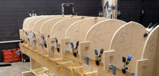

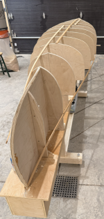

Next up, were station blocks and setting up the mold (the first time). I marked my 12" lines from centre, installed my blocks, screwed in my molds and grabbedf a few ew random strips from testing a ripping on a table saw vs bandsaw.
What i had looked pretty cool, but somethings were weird. Among my concerns were the stem to station 6 union, the interface between the strips and the stations, and some lurking feeling that I made a mistake. I fussed around, thumbed through the book, etc. and it turned out that i had affixed my molds on the wrong side of the line which was a big enough error that i forgot about everything else. So everything came off, then went back on.
I was still waiting on lumber which I believed would be the next step so I killed some time making a new router table/plate that could fastened between two sawhorses and corresponding in-out feed tables when I needed to start putting the bead and cove on. Although I have made a few router table tops, I recently ended up with a new router with variable speed and a 1/4 or 1/2" chuck but a larger base plate. I used an 18mm off cut and some acrylic sheet then routered out the plywood so that my acrylic sheet would sit flush. I have made a handful of these where normally I hole saw my center hole, then awkwardly router out for the acrylic. I have never had great equal contact between my acrylic and my plywood so i end up using masking tape and or hot snot to shim up my acrylic flush. This time, i just started my center hole with the hole saw, then routered out the recess while the hole-sawn section was still present which allowed for consistent support for the recess-routering router. And who knew, i actually ended up exactly were i needed to be with full contact and no shims. happy day.
At some point during clean up i plopped in on my strong back and noticed that it looked really pretty alright there and if I could maybe suffer cutting my strongback top plate, install the new router plate, then i would would address some flexing concerns I had about the router assembly and at least have one perfectly flat in or outfeed table.--it later occurred to me that i also could have just recessed and new router plate area right into the top plate..oh well.
Notice in the photo above that there are no station molds on the strongback even though they had been installed for the second time...It turned out that part or "my" plan necessitated the use of the strongback processing the lumber but i was so excited to see the mold...another mistake.

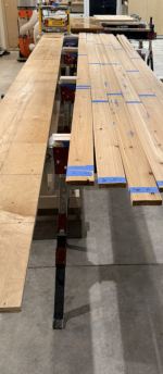

I started off by planing down 6 pc of 1.25" x 5 3/8" decking to 0.75". I plopped the planer in the middle of the strongback and installed some bench rollers for in and out feed as well as some additional roller stands. Recently I have only planed some really pretty wonky undressed hardwood 8/4 and 6/4 using a 12' long planer sled so this was an absolute treat but it did hurt to fill a whole dust collector with shavings, maybe even twice.
The same blocks that were shimming up my bench rollers to match the planer table where cut long to be the supports for ripping my strips.
I used one of my planed boards as a circular saw table support, and ultimately found that applying 3 or 4 strips of double sided tape under the board being ripped was the more efficient and effective way to keep it in place while being cut.
I used a track saw for my ripping but no track. Instead, i picked up two cheap circular saw ripping fence guides, ground them down until they fit inside the slots on the table of my tracksaw, attached a long 5/8" square of hardwood and ended up with a fairly robust ripping fence with lots of forward and rear support that could be adjusted and squared. It work out fine.
I think the best part of a track saw is the dust extraction. When paired with a good dust collection, it had limited clean up and practically (if not actually) zero dust in the air. There is a photo below of dust pan after 18 rips if not more.
I noticed at some point that occasionally, a ripped strip would go really wild and appear to zig zag. At first I thought it was just built up tension in the board but i ended up concluding that going too fast/labouring the saw, accidently lowering blade rotation dial, or cutting at the end of a battery life was the cause of spaghetti strips. I am not 100% on this theory.
I also switched from a Milwaukee 40t 0.0645" blade to a much thicker Freud14t 0.098" kerf blade and it rocked. The 40t blade yeilded 18 strips per board and did a good job but was prone to spaghetti, but the Freud was incredibly fast, easy to move through the rip and only cost me 2 strips per board.
In total, 6 boards ripped, 18/board with the milwaukee for 2 boards, 16/board with the freud for 4 boards. 100 strips in total.
Next up was thickness planing the strips down. I had ripped my strips thick enough to make sure i could remove any saw marks or burns. They were really good before hitting the planer but i was kind of stuck as i did not want thick strips and using my long work bench as an outfeed and strong back as and infeed was fast enough when gang planing 10 strips at a time. The real pain is getting everyone level.
Here is a photo of getting the planer in position and then a photo when ready for resizing.

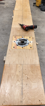

Onto milling that strips--and here is where I felt like i unlocked something kind of neat...
I got my planer out of the way, pulled my work bench up to my strong back and got everyone leveled up and ready to install fences dust extraction, etc. Some how, I messed up and my router table fences had to be on the "wrong side" for the feed direction to work and for me to be able to move up and down the line without having to reach to the other side of a 4' table, or run around all of my sawhorses acting as milled strip sorting and storage. I could not wrap my head around how to remedy this so said f-it lets get going.
here is that setup: Not some spaghetti strips on the table in the background
I used the suggested method for getting my bead bit and fence in the right spot and went nuts with feather boards and fences. I probably ran a dozen strips through and was very happy with the resulting product but it took forever and I could not for the life of me keep my strips moving at a consistent pace. This didn't result in and burns or bad beads but it sucked, i was gassed and I was not looking forward to finishing my bundles, then having to do it all over again to put my cove on. In finding no joy in the task I called it a night and sat down to drink beer and stare at my set up.
I wanted something like the Nick Schade power feed stock roller but could not justify that kind of purchase and had not seen anything available used. At some point i figured that i have a feed rollers in my thickness planer and i know that it will feed but not cut if you set you height just so, but whatever research i did said that 26 fpm is too fast and I had "cheaped out" on an onsale DW734 instead of the DW735 which had an adjustable feed rate, also if i put my fan speed regulator/interrupter on the plug on the planer then either the regulator would burnup or the planer would...
By morning i figured it would be worth the hour (i thought i would be 15mins) to move everything around get my planer in the line, get everyone level and stable and maybe cause some catastrophic failure at 26fmp with some of my lesser strips. I popped a strip in and just about had a s*** as it went through, then a full length strip with a follower and it was working like a hot dang! So that is my "kind of neat" thing that i figured out.
Unfortunately, i did not take photos of the arrangement but here is link to a video of the set up in action:
I am not sure if i can insert a video, if so, please let me know
After the some minor changes, the set up was this:
-~10'x4' work bench with some supplemental sawhorses as infeed
-8' long 1" aluminum angle clamped to the table inline with the router fence
-4' long 1" angle clamped at a bit of an angle opposing the 8' piece to act as an infeed shoot so my spaghetti boards would head straight to the router
-then the planer setup just so the feed rollers were touching the strips as they passed through and the blades were not cutting
-at the outfeed of the planer, a board was clamped to extend the router fence right up the the outfeed of the planer
-a roller guide with oneway bearings on the opposite side of the router fence was angled to force wayward strips into the forest of featherboards
-then came the router fence, forest of featherboards, cove or bead router bit, then more feather boards and another 8' of 1" angle with some gratuitous feather boards and blocking
Ultimately, the milling process became very quick with a few hiccups here and there. Generally speaking, I would work one bundle of 16 or 18 boards on my work table at the infeed all place to ensure the correct side was about to get processed, then feed in one strip, once it processed far enough down the line, another strip could be sent in directly behind it to push it the rest of the way through the router.
I would then move down to the outfeed and slide the finished strip onto the rack and head back to the infeed to get another strip into the feed shoot to keep a constant line of strips processing.

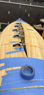

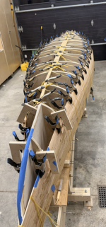

It was finally time to start building. I took no photos of reinstalling my molds but I did end up making the decision to shorten my station distance by 1/8" in hopes of reducing the length of the boat to allow for my strips to span the length of the canoe with out requiring any scarfs. I had intended to knock the hull down to 15'8" but on the fly decided to keep the distance from 6-7 and 7-stem the same. Additionally I decided to put a uniform 1/4 (or 1/8") round over on all the stations believing that it would reduce strip bruising from the sharp 90 degree face that the strip inevitable crossed at angle. I also figured that it would slightly reduce the size of the hull perhaps even proportionately with my minor length adjustment.
When i went to install my first strip that intended to be sacrificial, I also noticed that it was possible and almost easy to conform my strip to the sheerline and always thought that looked prettier. For some reason, I believed that this would be the longest strip on the boat and was the most difficult to install. Soo...if my first strip went on easily and was long enough....then i'd be done in no time and why did i buy all those clamps and zipties and cutup all those innertubes?
I figured out pretty quickly that screwing my starter strip into the forms was as easy as it would get, but just gluing my first real strip on would be more challenging. And basically exponentionally more challenging as i continued. At some point in the first 4-6 rows i figured out that i did not have to apply glue to the full strip before installing, that relieved a lot of pressure. More clamps were made and given a colour so i would know what i was reaching for (black for normal, blue tape for jimmy), then dowels and surgical tubing came into play and cleats and wedges.
I also discovered that scarfing would be necessary, and that I would struggle getting the bow stern pieces to always nest even under immense clamping for. So some pretty bad scarfing was done and let a few crack slip in here and there.
I also got a little lazy with glue squeeze out thinking that i would be super easy to clean up. (the screws in the bottom left were just on the block i used, they dont get screwed through the hull)

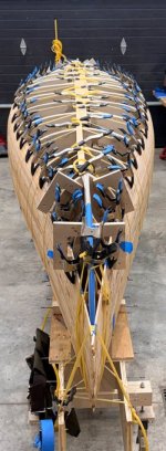

Eventually, every strip resulted in a choas round the work area, oodles of tubing, and more and more clamps
I also was having trouble keeping the hull conforming to the stations when the straps were removed to install subsequent strip and even tried some hot snot on the stations. This worked pretty well but just taping everything off was time consuming.
More tubing, more clamps, more mess for each strip.
Then, after waving this thing at the hull i dont know how many strips, i finally caved and placed a brad, and other and another.

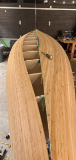

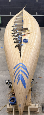

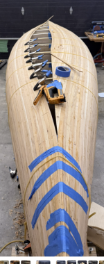

Then really quickly i got to cutting my centreline and closing the hull.
I broke some cove lips trying to fit the first few closing strips, and unfortunately had some suboptimal gaps but after 3 or so i figured it out. It was definetly challenging to make sure full length strips were the right length after getting them cut, but i likely spent more time sorting book matched strips and walking up and down step ladder than actually shaping the strips.
In some cases, i had to adjust my centerline so that my tips would match up. It was not impossible but i didnt fully get the hang of it until a few had already been installed a few muddled my centerline a bit.
Pretty soon it was whiskey strip time. I spent way to long digging through scraps to find a nice piece of cherry that would yield a good book matched bit of heart and sapwood that matched the shape of the joining pieces. Then when i marked it for cutting i discovered that i would cut most of the heartwood off and that the birdseye piping strip would actually be about 1/3 of the strip.

That's the way to do a Whiskey strip !
Nice work !
That looks like a perfect set up. And honestly, I think the reason I couldn’t keep a good pace originally was because I had too many feather boards in place and likely too much pressure on them. But the set it and forget it system made me pretty happy. For my last batch I think I may have put a cove on half my strips in under and hour just feeding the pig and getting a steady stream of ready to go strips out the other end. With another set of hands and/or maybe a sloped portion of the outfeed to a sloped deck so strips just slid off, I bet you could batch out a canoe’s worth of strips in an afternoon. But who knows. It may have taken just as long to just push them through normally if you account for the amount of time I spent setting up, brooding, looking for posts about other dummies that tried my theory already, setting up again, leveling, re leveling, etc.
Re whiskey strip, I believe I saw an exchange on a post between you and cruiser where you had suggested staying several strips back not just 2. I thought that would be excessive (inspite of looking at the exchanged photos) then when starting into make my strip I was considering goring out a strip or two so that I could have more to play with.
Regarding gaps and cracks and errors: I found that I was carefully taking photos throughout the build so that the ugly bits or excluded or blurred… before fairing I took a pretty thorough inventory of all of my errors, some of those photos may have been included above, but I’ve got an album of shame that may or may not be shared.
Lots of credit to you, cruiser, stripperguy, Alan Gage, and many others from here for this build!
