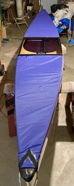

For my purposes partial spray covers for solo canoes have advantages for non-WW types of tripping and day paddling. Easier entry/egress, less potential entrapment hazard, fewer snaps, and easier to access gear, including day gear in an open area behind the seat. I feel better about using a portage cart strapped around the open center with the partial covers left in place.
PC110013 by Mike McCrea, on Flickr
Perhaps not just solo canoe partial covers. A belly cover across the middle of a tandem canoe, from behind the bow paddler down to the stern paddler’s feet (or shorter as desired) would be even easier to make. Possibilities as well to make a partial shade and rain cover for a dog companion.

Or a custom ice chest cover, with end bilge length end drapes to keep the sun off and the cool in. Lot of possibilities, including custom covers designed for fishing or hunting.
If you have serious sewing abilities just skip using the heat healable fabric altogether, use some coated nylon or poly material, although some of the how-to steps in making templates and seating snap buttons, sockets and studs may still be helpful.
I don’t see the weight savings of lighter denier heat sealable fabric as being worthwhile. Not for DIY dry bags, certainly not for spray covers. I would use the Packcloth material.

I now have covers for the Rendezvous.
I messed up at the stern, not leaving enough material to install snaps on the underside of the deck. So, the stern cover got a velcro strap that loops under the deck plate. One mess-up desrves another--it somehow didn't make sense to tape off the outline of the area on the cover where I glued the straps. For some reason, I was thinking the glue would glue the tape on and I didn't want tape glued to the deck. So, an ugly result, which should not detract from function.
