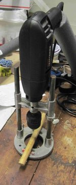

I have muddled through with one of these Portalign drill guides, and I have to say, it works pretty dern well. I have a corded drill dedicated to it. It is surprising to me that these are no longer made. 1000% better than eyeballing it. Someday I will grow up and get a drill press and table sander.
I'm with you. Poor man's drill press. I've had it for about 40 years, and like you, dedicated a corded drill to it. It really is quite a clever design, surprised it isn't made anymore. I never really had a shop large enough to set aside the floor space for a drill press, and in my 20's wouldn't have had the $ to buy a drill press.
The Port-Align drills round stock, self centering on ~~ 6 inch or less wood, stops for setting drill depth,etc.. Well worth the $20 or so I paid for it.
