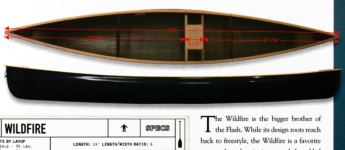

You can also scale the distance from a catalog picture
hey, something i'm qualified for! (note that i scaled the boat length as 168" from tip to tip, so Ecksilon's actual tangible canoe measurements are far more useful)wf.png
hey, something i'm qualified for! (note that i scaled the boat length as 168" from tip to tip, so Ecksilon's actual tangible canoe measurements are far more useful)View attachment 153750
Gadabyte, your picture measurements are of a composite Bell Wildfire. The OP, @John B, has a Royalex Bell Wildfire, later renamed the Bell Yellowstone, which is a different-shaped hull than the composite Wildfire. @eckilson measured his Bell Yellowstone. @stevet measured his composite Bell Wildfire. The measurements are different, which is maybe meaningful, maybe not.
No one other than Bell made a Royalex Wildfire/Yellowstone, but five companies have now made composite Wildfires. I'd be surprised if all five companies put the seat in the same place. It's not uncommon for paddlers to be dissatisfied with factory seat longitudinal positions, heights and cants in both solo and tandem canoes.

my bad, thanks Glenn. here's one from the same catalog gumpus linked, but for the yellowstone solo. agreed on the self-measuring, even coming from my furniture/cabinetry background - physical reality is always a lot more accurate than a tape measure, and certainly more accurate than scaling an image (even if i do have the right boat this time).ys.png
Not necessarily. I wouldn't assume that all Yellowstones that shipped from, or were photographed by, Bell had the seat in identical positions. Your measurement shows the seat further back than @eckilson's 3 inch measurement, but that doesn't mean his seat was placed "properly" by the factory guy. Someone else's Yellowstone seat may be closer to your photometric, as the composite Wildfires seem to be.
