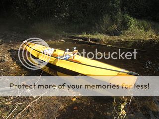

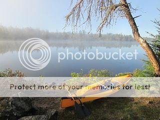

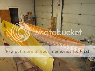

I've built several canoes, using a similar method as you describe .
I just finished up a 38 Spl. ( Bruce Kunz design.)16'3" about 29" wide.
So I use a Stripper as a Male mold.
Using a stripper, has the advantage, of also using the forms, to build a 1/8" thick, Cedar insert, instead of foam. My insert is stripped on the same forms as the stripper. This enabled me to duplicate the insert shape and the hull shape.
If you can vacuum the insert to the inside of the hull, you will do yourself a big favor!
I opted to strap the forms on top of the insert to force it, to compress the insert to the hull, with resin and filler mix, between the hull. I had mixed results. One ? I could have used more epoxy/filler mix.
So for a release ? I cut and taped, window heat shrink film, over the foot ball of the mold. Then coated the sides of the mold, with Partal. Three brushed on coats.
Using just Partal for the whole hull ? I was afraid I would have trouble getting the hull to release easily. The film works good.
The hull has quite a bit of Tumblehome. The Partal held the wetted fabric good to the hull, on the sides. Plastic wouldn't.
So for my Lay up, I went with one layer 6 oz Kevlar.
Now here is where you can save some weight, and resin. Peel Ply doesn't conform well over the multi curves of a canoe , without wrinkles. I'm advocating using plastic film, in place of Peel ply, to reduce the amount of fill coats.. Here in lies the problem ! Getting the plastic on the wetted cloth, by yourself !
This is what I will try on my next build.
So my layup.
On top of my prepped hull. I wet out the Kevlar. I let it cure just past the tacky stage. Then apply 4 oz S-glass. Plastic film over the wetted S-glass, will reduce at least one fill coat.
Yes, Leave the ends open.
One note. The outwhales must be removed if you are starting with a finished canoe. In my case I'm using an unfinished hull, for my mold. No trim.
After the lay ups have cured, I wait several days. The hull removes easily.
I set the hull in some saddle stands, with support between the saddles. I had a hull collapse on me once. A hard lesson to learn. At this stage the hull is still flimsy.
Now is when I add the insert. Again save yourself some headache, and vacuum bag your insert, whether you use foam, or make a wood insert !
Once the insert is glued in ? Feather the edges of the insert.
I used 6 oz E-glass on mine, and glass the inside, on top of the insert, up to about the 4" water line. In the area of the seat ? Ill add another layer of cloth. I used 4 oz S-glass, as I had some scrap.
That is my hull.
I used Bell Aluminum gunnels, and Plastic end caps. I also build large flotation chambers on the ends.
I'll try and answer questions. To date I've built 7 composites. I make my seats, and they are heavy at 2.5#
Of course I varnish the hull.
This one came in at 37#. I'm very happy with it, except some of my glassing could have been better !
No Oil canning with this method. the 1/8" cedar insert adds plenty of stiffness.
Sorry for so much information, and long post !

My previous composite.
