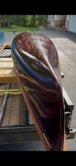

I'm a man, so I'm always shopping for an upgrade. One of the things that keeps me from buying a brand new canoe right this minute (besides price and lack of test paddle access) is this indecision over layups. 28 lb ultralight, or expedition weight? Yeah, that's a tough one when you're talking about $4k US. But time for spending the money and wearing one out grows short.....
Pika, as an aside, the area you describe is likely the most vulnerable area on the entire canoe, had you impacted anywhere else, we probably wouldn't be having this discussion.

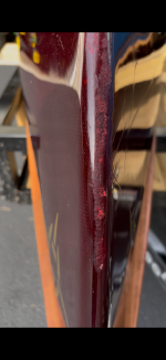

That is an interesting point. The cracks are not directly at the point of impact (at least I don't think so), they are in areas of greater hull curvature above and below the impact.
I'm in the "patch it, paddle it, enjoy it" camp but it depends on the extent of the damage whether I'd bother patching it.
If the glass is intact on both inside & out and the cracking appears to be limited to the core (does a fingernail or ball point pen catch in any of the cracks?), I'd probably just paddle it, figuring the odds of hitting the same spot might be pretty slim.
Of course, your destination may impact the level to which you repair also... If you're headed to Crown Land for a 3 week, off grid, solo I'd be more likely to repair than for a day paddle on local waters with easy road access.
