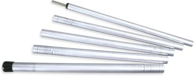

You might want to check out the collapsible tarp poles from Tatonka.
Take a look at the pictures - I’ve set up a 4x3m tarp using four of those poles.
View attachment 153724 . View attachment 153725 . View attachment 153726
on this pics you see a DD-tarp 3x3 on trees and poles ...
View attachment 153728 . View attachment 153729
Those look suspiciously like the 5 piece Eureka poles I've had for about 25 years, I wonder if Johnson Worldwide sold the patent to them when they Folded Eureka

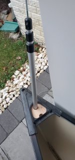

So the point of the pole doesn’t poke through the tarp I made a little disc to spread the load. The pole has other uses too, I made this hook thing to reach high and push a weighted line through tight branches to get a guy line right where I want it and the hook portion can grab the weight on the other side to pull it down.
I did a thread on these a while ago when I made them but if I didn’t follow up they worked great and the hook thing made like a lot easier.
