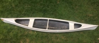

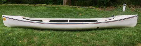

The Brownline Mayfly is an 18.5' x 34", fiberglass beast. The serial indicates manufacture in 1975. It's a fairly fast hull, but weighs somewhere around 90 lbs.
Brownlind-side1.jpeg - Click image for larger version  Name:	Brownlind-side1.jpeg Views:	0 Size:	253.3 KB ID:	113309
The "shedding" decks are a prominent feature. The builder told me the boat was designed for "pool and drop rivers like the Guadalupe." Odd, IMO, because it is a hull that likes to continue in a straight line. Does the Guadalupe run straight?
With 8' between seats, it seemed like a good social-distance craft to take out for a tandem, lake paddle yesterday, and it was. Thus, the Brownline earned another year in my "active" fleet. Any boat that doesn't get used in a year is in jeopardy of being purged.
A wedge of foam fell out from beneath the bow deck. The foam must have been placed there for floatation. I thought to glue it back in before paddling yesterday, but the prior day's weather became so humid the "under-deck" wouldn't dry. Also, I discovered the foam plug was also missing from under the stern deck, too. I ended up bringing extra dry bags, puffed with air, and strapping them in to keep the boat from sinking if it capsized (which we all know would never happen!). So, some work is needed. Or, just ditch the boat.

Also, due to the decks and recurved gunwales, it's really difficult to clean out mud. Refuse ends up trapped in the decks.
At the moment, it needs work, a big con in my book
Chip, if you do any work to the Brownline maybe drill half inch (or larger) drain holes near the tips of the stem. At least the small debris will hose out the ends.
It looks like the Brownline has a fat area centered atop both peaked decks. I’d be really tempted to add kayak-style carry handles to the bow and stern in those areas. I have added them to our heavy decked canoes for two person carries.

Water weighs ~62 lbs per cubic foot. So, roughly 1.6 cubic feet of foam will float 100 pounds. Technically, it is a little more, since the foam weighs a couple pounds. But, a lot less than 1.6 cf of foam will keep the boat off the bottom, since the water will support a portion of the weight of the boat.
Here is a photo of the "bun" that was under the bow deck.
The odd shape makes precise calculation difficult, but I'd guess the bun is about a third of a cubic foot, so will float around 20 lbs.
Something similar under the stern deck should be enough to keep the canoe off the bottom. So, the two cubic feet the quarts produce should be more than enough.
Urethane foam sounds like pretty exciting material to work. You have 45 seconds before it starts to foam. I wonder if I can mix it and pour it that fast, and hope it still pours while it is foaming. Some practice may be indicated. Have any dry bags you need filled?
