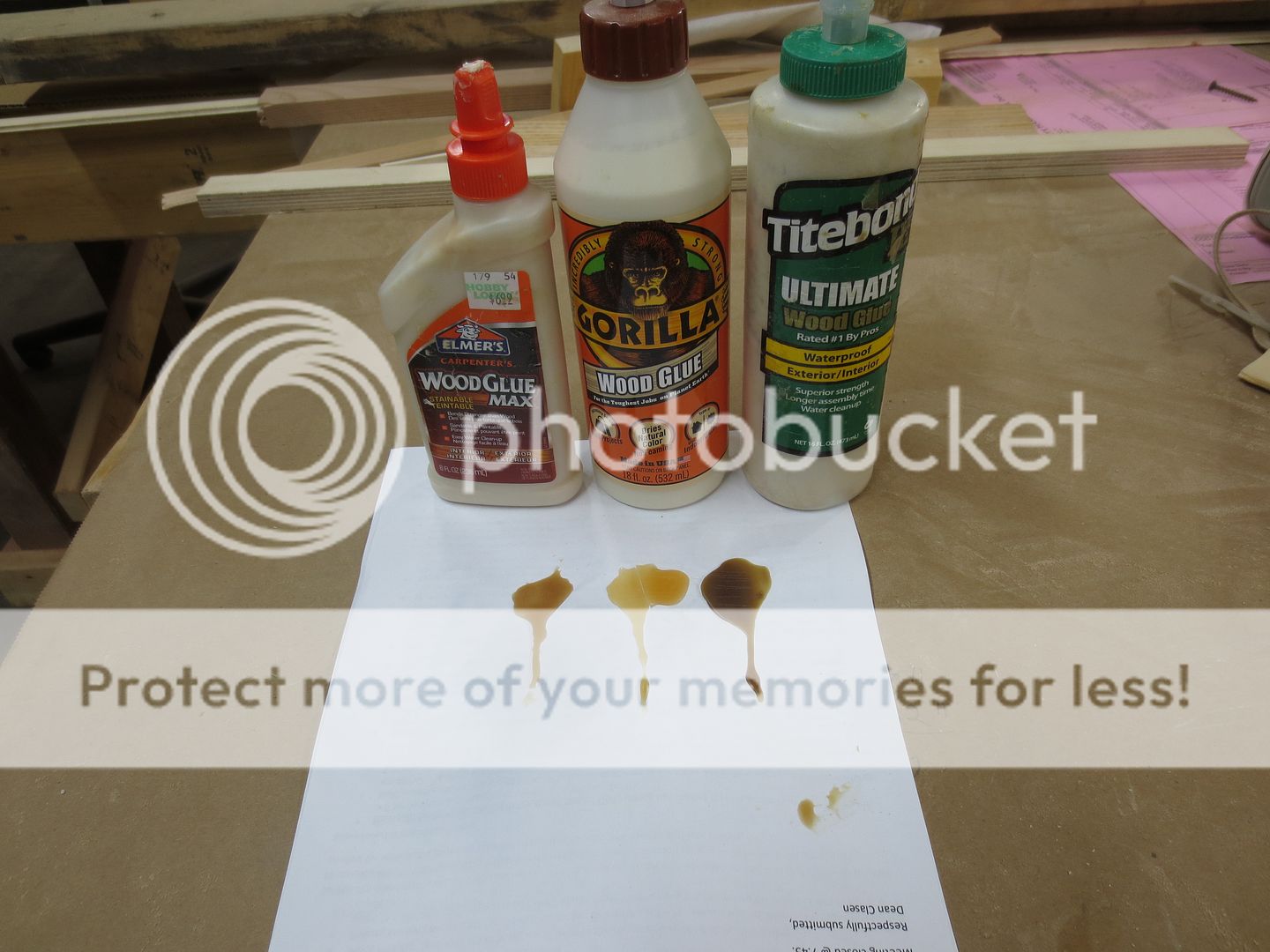

But here are the three glues I've used.
Elmer's Max, has been my favorite, and still is. The color draws me to it, as it blends the best with Cedar, under epoxy. I use it to fill staple holes, and fill small cracks or gaps.
Due to not being able to find it locally, at a reasonable price, I chose Gorrila Glue, this time.
I've also used Titebond III, but felt it was too dark.
I poured a little of each glue on a piece of paper, and let them dry.
Both Elmers Max, and Titebond III, dried Flexible. Gorilla, dried hard, and cracked when I flex it like I did the others.
The Gorilla glue sands easier, with no gumming of my sand paper.
So for the build I'm doing now, I choose Gorilla glue for strips, and Elmers to fill .

Open time on the above three, is fine, for me.
The ability of a glue staying where I put it, without running off, is important to me.
Gorilla did great, as does Elmer's Max.
Titebond III worked without issue.
