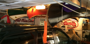

I use this custom made wall rack in my lake camp garage. Made by a small company that also mskes rustic cedar furniture.
Second rack filled & ready for winter storage
Plus one on the ceiling with a home made lift
Plus three more on ceiling lifts in the garage at home (no image)

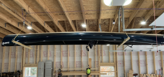

That’s what I built in Wisconsin. A little more involved at home with drywall walls and no space in the garage, but definitely easier to load, unload.
