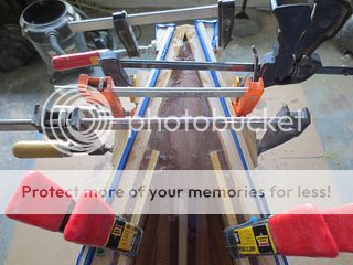

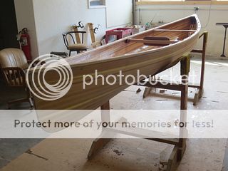

Another clamping system, is the "Dragon Teeth".
They are used to hold the outwhales to the deck area, without fasteners. Used exclusively when you glue outwhales on.
A pic, I hope that gives you enough information, so you can see how they work.
Dragon's Teeth
The red spring clamps, hold the Dragon's Teeth, to the hull.
The angle cut wedges, keep the clamps from sliding off.
The blue tape, is between the outwhales and the Teeth, to keep them from sticking to the hull.
the Results, Look Mom ! No Screws!
Screwless Outwhales
Oh that looks slick, and the final product is so clean! If I understand correctly they're essentially angled wood block 'pads' that work as adapters so that you can apply pressure with standard bar clamps? That could be a good way to use some of my bar clamps when I build my first stripper.
