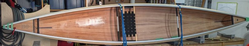

Everything is taking a lot longer than it should at this point sine I don't want to screw it up. I made a small drill guide to drill the holes for seat brackets. I wanted the holes low enough on the brackets so there would be some material left above the rivets for strength. The opposite on the aluminum. Since the inside of the aluminum gunnel is slightly shorter I flipped the boat up on edge and drilled from the inside out. I drilled 1/8" pilot holes then enlarged them to 3/16" after before lining up the seat brackets and drilling them to match. On my Caribou there are only 4 rivets holding each bracket on but I thought with the material I remove drilling holes It's about even with an aluminum rivet weight wise so I added a couple extra.
As for the location of the seat: In another thread I saw @memaquay sharing his experience of 10" aft of center being a good compromise in his Osprey. I went with that and added 6% to it for 26.9cm aft of center to the front edge of the seat,
I used a Q-tip to paint epoxy in all the holes to seal the wood before riveting with an aluminum backing washer on each side.
With the brackets installed I spent some time squaring then drilling the seat. I mounted the seat with M6x40mm SS flanged socket head cap screws but I was short on 6mm nylocks. I put some 20mm SS washers underneath on the 2 nylock nuts I could find. I need to order some more nylocks and the seat bolts are also still a hair long. I might pick up some M6x35mm or I might just cut these down a little.

@Jim Dodd When I read Dogbrain's build thread he had said he mounted 8" aft of center but he commented in this thread that he later thought he moved it back further. I believe it was in Dogbrain's thread where I found this quote by Memaquay and saved it to my build notes.
"I paddled a cedar strip Osprey for many years. It is the same boat as the Kite, except for the difference in the tumblehome construction. Factory Ospreys come with a sliding seat for adjustments to trim. I just installed my seat about ten inches aft of the centre point. I found this to be a good all around compromise, and didn't struggle much with broaching from the stern. I put several thousand tripping miles on that canoe in a variety of demanding conditions before I finally wore it out. It was my first dedicated solo and only my second build, so I have very fond memories of it."
In order to copy the cockpit from my Caribou I need the seat mounted as a reference point so I can install the footpegs and the thwarts. I really appreciate it when guys share their experience like that.
Also I forgot to mention I used longer rivets to mount the seat and hangers that the 3/16x1/2 ones I was using previously. These ones were 3/16x 25/32. Also a picture of the excellent conditions on the hill yesterday.

After some chores I spent some more time in the shop. I mounted the stern carry handle, placement was dictated by the width of the drill. I wanted it close to the float tank but far enough out that there wouldn't be any knuckle contact and also easy to clip a dry bag onto. The soft jaws in the vice didn't work. Extra tape and metal jaws worked well though. I bought some heat shrink grip stuff for these. I painted some contact cement on slipped the cover and hit it with the heat gun. After riveting it feels pretty solid.
After laying out the footpegs in the morning I flipped the boat on it's side and mixed up some epoxy and wood flour to get the studs started. I gave myself the distance to my footbar in my Caribou plus a few extra notches if someone taller paddles it.
The new end caps arrived but unfortunately didn't work out. I'm going to have to make something there. I had a good day in the shop though. I got the gunnels drilled, epoxy sealed all the holes and got them riveted on with back up washers. The thwarts are installed and the other set of studs are started. I decided to put the heat shrink tubing on the thwarts as well. Hopefully it holds up. When I put it on the front carry handle shown in the picture I heated it too much. When I drilled out the holes and trimmed it, it tore back. It could have been from not letting it fully cool too? I cut it off and re-applied it. When I re-applied it I went light with the heat gun on the ends. The thwarts and carry handles are 1" tubing I orderedt from Clipper in case I didn't mention that previously. They went on pretty smoothly. Trim close to length, mark the angle, tape then flatten in the vice, trim angled flange to 12mm, mark/flatten/trim the other side, drill holes, drill/install one rivet, line up square then drill/install the other three rivets. I also found that a 1/4 drive 6mm deep socket worked well to help tap the rivets into place when they weren't going in so easily. Another tip would be to start with the longest thwart first in case you screw it up. I realized that would have been a good idea after doing the opposite.
Jobs left now are to glass in the pegs, lightly clean up the hull for varnish, install some gear tie down points, varnish and sort the end caps. The boat will have to sit for a few weeks until I get some time to finish it up.
Here's a few pics of installing the foot braces from before I went to visit family. It's still winter here so there's still no rush for me but I am feeling the pressure to get at it.
When I first epoxied the studs in I used a chisel the next day to remove and any excess schmutz. When I glassed them in I started with another thin layer of schmutz, put the first layer of glass on and worked the schmutz into the glass. The schmutz makes a decent transition from the metal to the wood. I then put a second larger layer of glass on top and wet it all out. I made sure I flattened it more on top of where the metal was. I should have spent a little more time doing that.
The next day I used my scraper to clean away the edges and give it a smooth transition. I used a gasket scraper to clean it up as much as I could around the base of the threads.
After getting it together I see I should have spent a little more time flattening because I don't have any extra thread valley showing on the nylock nuts. We'll see after I finish sand them. I can always take a little off the back of the bracket and use some Loctite on the nut. I see the right side pedal is upside down, I'll correct that when I varnish. Hopefully I got the height right because those are really on there.
