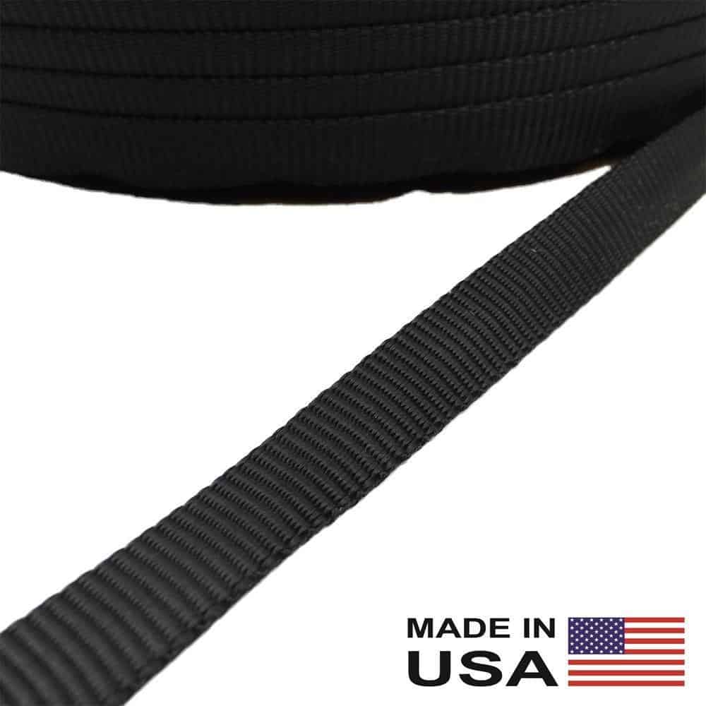

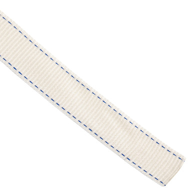

My favourite webbing, is also the thinnest. It is made of Dyneema so it is not impacted by UV, it is very supple so easy to bend and fold, it is a little pricey though
second from this vendor

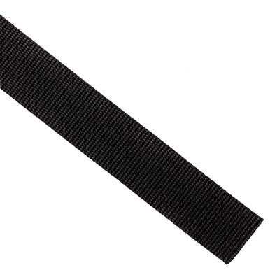

and an additional supplier for nylon webbing
and a second offering from this supplier for Dyneema webbing
There are a couple of other suppliers I use, but whatever products you get from these will be the better quality of the various types, plus they give strength/weight bearing values .... I find that just finding the right vendor can be the main challenge, these are both good places IMO. The second vendor also offers many colours, so matching the vehicle colour is likely possible, if that matters to the buyer/
