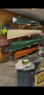

Gumpus, where did you get those wall racks for your canoes? My garage is getting very filled with 4 canoes on sawhorses and kayaks underneath the sawhorses or hanging from rafters...I'd like to get a system like the one you have in this photo...Thanks!
The racks were built for me by a carpenter that probably spent too much time on the details. I think the key for the design is starting with a 2x4 or 2x2 anchored very securely to the wall. If I was going to DYI I'd pribably try to find a suitable design on YouTube that uses plastic plumbing tubing...or maybe just go with the design Lance posted.

I just had a large new garage built at camp last year with a wall of canoes on cedar post racks, made by the same local carpentry guys who make all of my camp inside furniture the same way. Since this photo I have installed a second set for canoes I have for now stored in another shed by the water in the summer. i also have a very high 12 foot ceiling pulley hand lift system for when I run out of wall space.

I just had a large new garage built at camp last year with a wall of canoes on cedar post racks, made by the same local crpentry guys who make all of my camp inside furniture the same way. Since this photo I have installed a second set for canoes I have for now stored in another shed by the water in the summer. i also have a very high 12 foot ceiling pulley hand lift system for when I run out of wall space.
