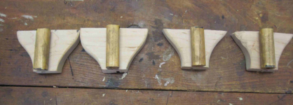

Late to the show, but here's what I remember from the solo conversion I did. I've been rooting around for useful photos and will post if I find them.
1. The canoe heels quite readily so a wide seat allows you move easily to either side. Well worth it in my estimationn.
2. Replace the OT dowel hangers with ones that inhibit seat sway.1749049352097.png
3. After removing front and rear seat, each seat location got a thwart.
4. I added a foot bar and back band(not shown here).
5. Not shown in photo but had a front cover made for the canoe, to help with windage, and shed water from using a double. Snaps for the cover show on the picture of the hull.
6. Installed a 2 inch webbing carry yoke, sufficient for getting canoe from the water edge to the vehicle. Rolls up out of the way when not in use.
2. Replace the OT dowel hangers with ones that inhibit seat sway.View attachment 146981
