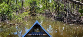

Today the tide and wind predictions were just about perfect for one of my favorite paddles.
Paddle Plan:
•Launch at Robinson Preserve south ramp
•Paddle through the preserve to the north cut into Tampa Bay.
•Get to the cut at high tide (current can be strong at other tides)
•Head west to Perico Bayou with a tail wind
•Return to the ramp through the mangrove tunnel.
The trip started out great. I got to the pass at high tide and Tampa Bay way calm with a nice view of the Sunshine Skyway Bridge (first pic).
Tail wind paddle through Perico Bayou and found the entrance to the tunnel without having to cheat with my phone map.
The tunnel was navigable with a few obstacles to get around (second pic). About ¾ of the way through the tunnel there was a medium sized branch blocking my way. It was too high to scoot over and too low to limbo under. I was about to head back the way I came but I really did not want to fight the wind and the outgoing tide at the cut.
I decide to try to move one end of the branch. It was tricky maneuvering myself close enough to grab the branch but I was able to pull one end of it into the water enough for me to scoot over.
I would not have tried this in a canoe less stable than my Camper.
I don’t love lifting the 65 pounds but the stability and Royalex durability are too good to give up. I guess that I will keep it until
I can not lift it anymore then figure something else out.
