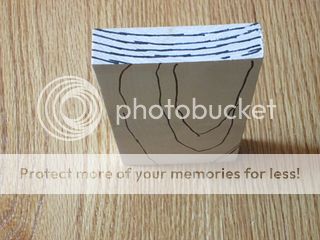

I've delved into this a few times, over the years.
If you are cutting strips from 1X stock ? Purchase Flat grain, or Slash cut planks.
This will yield Quarter sawn strips.
These will be the strongest, non warping , easiest to sand, and machine, strips.
Some will tell you it doesn't make a difference. BS, in my book
Here is what the grain, of your planks, ideally should look l
Here is what the grain, of your planks, ideally should look like.
I forgot to mention, Jim, I can't see the picture: tried refreshing the browser. Maybe it's just on my end!
Cheers

@Jim Dodd, the picture didn't come through for me either. Might need to click the "insert image" icon above (just to the left of the smiley) and the drop your jpg file into the pop-up box to upload the image. In that way, the image will remain visible until this site goes dark (unfortunately, they all do eventually)

Hope it works this time. Been having trouble with Photobucket lately. They take my money, but reduced the service. Very hard to share pics !
Check my original post. Click the blue link.
Sorry and Thanks for the heads up guys !
