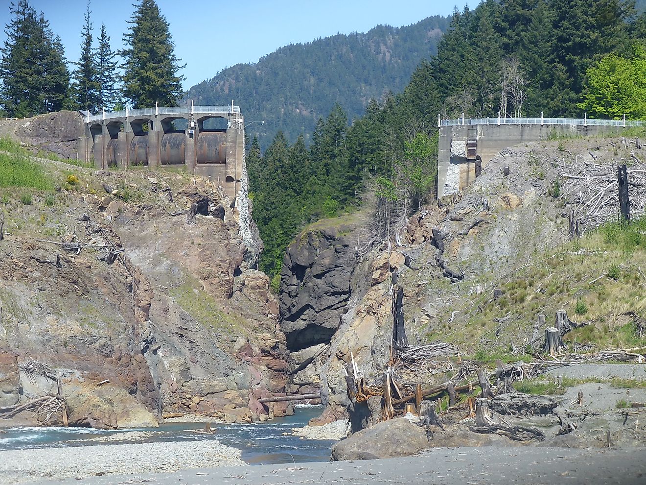

In 2005 or so, I did an art project for a Sandy River dam removal project. The Sandy drops of of Mt. Hood into the Columbia River... downstream of the lowest Columbia River Dam. At that time the experts did not know how long it would take for the river to return to a natural state. They estimated several months to a couple years. It reverted to a braided mountain river in 3 weeks!. Salmon returned with the first possible run. The trout guys at Western Rivers Conservancy were pretty happy.
I recommend reading about the Elwa Dam removals on your own. The process before, during, and after, was well documented.
