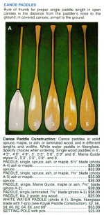

Getting back to what the Maine Guide paddle is. I remembered seeing a vintage paddle a few years before, it had the same oversized blade as the one I recently purchased, but was only 60 inches. It was an Old Town paddle and I think may have been labeled a "guide" but I'm not sure. I would have bought it if I realized its significance, but I didn't and I already had too many 60 inchers. Now looking back and wondering what makes a Maine Guide paddle, it's not the length or the type of grip, but the size of the blade. This makes sense, because in the tradition of the Maine guides they would take out clients that did not help with the paddling. They would need a bigger paddle, including the blade. to compensate for that. Coincidently the paddle paired perfectly with my 20' EM White, which was also popular with the Maine guides.
The blade on my guide paddle is 8.5 inches wide and about thirty inches long. It's probably only an inch wider and longer than my other beavertails, but it is significantly bigger and noticeably does more when it comes to moving a boat. Besides that feeling of moving the boat better than anything else, I've also done things with it that I had never done with another paddle. Once when fishing I had to use my paddle with one hand to keep my boat on course. It was a windy day and when I picked up the paddle to change course, instead of reaching and putting the blade in the water I just held it up and caught enough wind to do what was needed. I was pretty impressed with this and did a little experimenting. I wanted to see if in a tail wind I could catch some wind and pick up speed with it. It did, and not only that, I could control the direction of my drift. If I held the paddle out on one side of the boat it would turn towards the other side. Unfortunately I haven't been using the paddle lately as it sustained some damage and I like it too much to chance damaging it more. It also has the downside of requiring more effort to use the an ordinary beavertail. Although it is a beavertail it is a different paddle when it comes to it's capabilities and I thought it worth mentioning.
It is the paddle furthest to the right

At the WCHA Assembly two weeks ago, a pair of "Maine guide" paddles made by Alexandra Conover were auctioned off. I think they went for $400. I inspected these paddles quite closely by eye and hand before the auction.
I shared privately that I thought they were the worst paddles I have ever handled and that I would never paddle with them. That was not a comment about their craftsmanship or beauty or value to a collector. It was a comment about their WEIGHT. In absolute terms, I wouldn't be surprised if each paddle weighed more than 40 ounces. Worse, the paddles were so BLADE HEAVY as to be, to me, absurdly unwieldy.
Except, probably, for one thing. Alexandra Conover paddles with those Bunyans using a specialized stroke that has been called the "Northwoods stroke." I've seen Rollin Thurlow use the stroke, too, and we have a whole thread on that stroke elsewhere. The video of Alexandra posted by @alsg above illustrates why the paddle's absolute and imbalanced weight is not unwieldy when using the "Northwoods"-type stroke. I'll repost that video from the beginning:
You can see that Alexandra balances (and slides) the weight of the paddle on the gunwale, which she uses as a levering point. Other paddlers who use the stroke, such as @Mark Z, have told me they lever off their leg from the sitting position. Since wood floats, there is not much weight on the gunwale or leg. In addition, Alexandra uses an in-water slice return (aka Canadian return, aka Guide stroke return, aka Knifing-J return). Thus, the weight of the heavy blade and paddle is buoyed up by the water throughout most of Alexandra's stroke. She only briefly lifts the paddle out of the water for the next catch.
I can understand the use of such a paddle with the Northwoods paddling technique, but I don't use that stroke as my primary stroke, and when I do, I still would prefer a much lighter and more balanced paddle.
