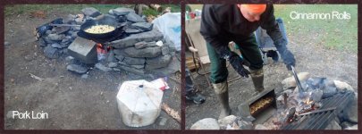

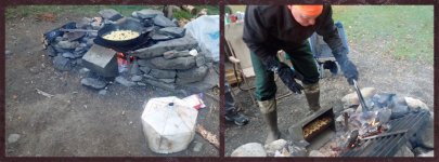

I've always thought that a reflector oven would be great for stuff that didn't need the long baking times - cookies, pizza, that kind of stuff. When we went to the Allagash in the Fall, a friend brought his reflector oven, so I got to practice with him. We made a few things in it - baked peaches with cinnamon and sugar (worked great), pork lion (baked while the rest of dinner was cooking, but did need to be finished in the frying pan), and cinnamon rolls (let them go just a little too long, but they came out OK). Couple of pictures from that trip.
His reflector oven has straight sides and a rectangular pan for baking. You can probably put more in the rectangular pan but once fitted in place. it was hard to rotate the food to prevent hot spots. If we could have easily rotated the pan, we probably wouldn't have had better luck with the cinnamon rolls.
What I liked about this version is that you use a round pan that can easily be rotated while you cook. The pan is another thing that you need to bring along, but there is probably something in the kitchen kit already that I can use - my metal plate or the top to the nesting pots. The problem is, I don't have a fire pit at my house, so it is not something that I will be able to practice.
