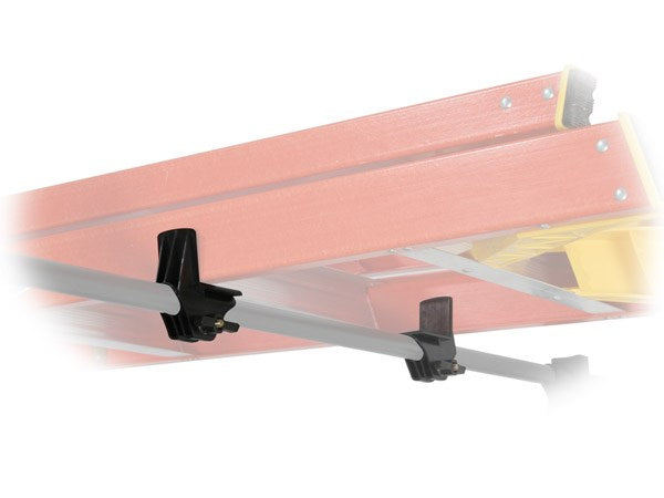

Now, where can I get, or more important, what do you call the stabilizer that fits on either side of the canoe gunwale when it is sitting, upside down on the roof rack?
I hear them referred to as load stops.
Thank you, Alan
I just looked them up. I’m not sure what the difference is, but that link comes up with $150, which seems unreasonable. I found them also for $78 for the set of 4 which seemed a standard price. Yamaha must have some kind of lock on the pricing.
FYI note: Yamaha charges about $78 for shipping. Etrailer has same price, but shipping is free.
Thank you, Alan
Why are you buying them from a motorcycle place?
