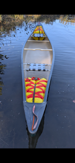

I've wanted to get into ww canoeing, but I don't want to drill holes in my only canoe (16' Buffalo, made in Arkansas). So I've been on the hunt for another canoe that I can outfit for ww paddling. I found this last night...

Seems like a pretty good deal for an Intrepid 16, but what do yall think?
I found a block post by Erik Ekilson's about the Mohawk Whitewater and how it is basically the same boat as the Intrepid. This got me pretty excited to scoop up one of these boats. Do you think it's worth it?
I'd buy one even though I already have seven or so canoes. For $150 it is well worth it.
I don't like to drill holes in my canoes either and I don't. The airbag lacing can be threaded through eyelets. Covers can be secured with heavy duty velcro. D-rings can do just about anything else. What were you going to drill the holes for?

I was referring to the airbag lashing and/or spray deck (maybe for the future). I didn’t realize I could get by without drilling. That’s great to know.
I watched some YouTube videos about outfitting an canoe for ww and the ones I saw all drilled holes in their boats
This video, they drill through the gunwales
In This one, ray goodwin drills the heck out of his hull.
I would prefer not to do this. What would you suggest? It would be great not having to poke holes in my boat

I think most people use paracord. Something like this:

To put in float bags you will need to drill holes somewhere. You can either drill through the hull just below the gunwales, or drill into the gunwales to attach d-rings or small lash straps. I've done both. The d-rings/lash straps make it easier to put in and take out the cord, but it is a little more work. On a Royalex boat, drilling through the hull is no big deal.
Finding bags can be a pain - maybe someone will have suggestions on that. Last couple of times I bought bags I bought from BPM in the UK. Nice bags, but I don't know how easy it would be to order from them now that the regulations on tariffs on small purchases have changed. They also use raft valves, so you need a raft bump.
You'll need to glue in some d-rings for attachments and some knee pads, and you'll be good to go. Just in time for the spring season.
I have had some canoes laced by drilling the hull (some royalex and some kevlar) and some laced with inchworms on the gunwales. I don't really see a significant advantage or disadvantage to either, except using inchworms requires more parts to buy but looks nicer. I haven't seen any sign of either failing in any way on my canoes or other's.
$150 for that Mohawk is a great deal if it doesn't need any expensive repairs.
Edit: drilling the hull and lacing the way I do it does have the advantage of doing double duty as an attachment system for a spray cover for when the added flotation is not desired, but that probably isn't relevant for a dedicated whitewater boat.

Nice find! For $150 you did pretty good.
I picked up an Intrepid 16 last summer and think it's a decent pick for a high volume whitewater canoe. Maybe not the most agile or responsive hull, but very confidence inspiring due to its initial stability and depth.
