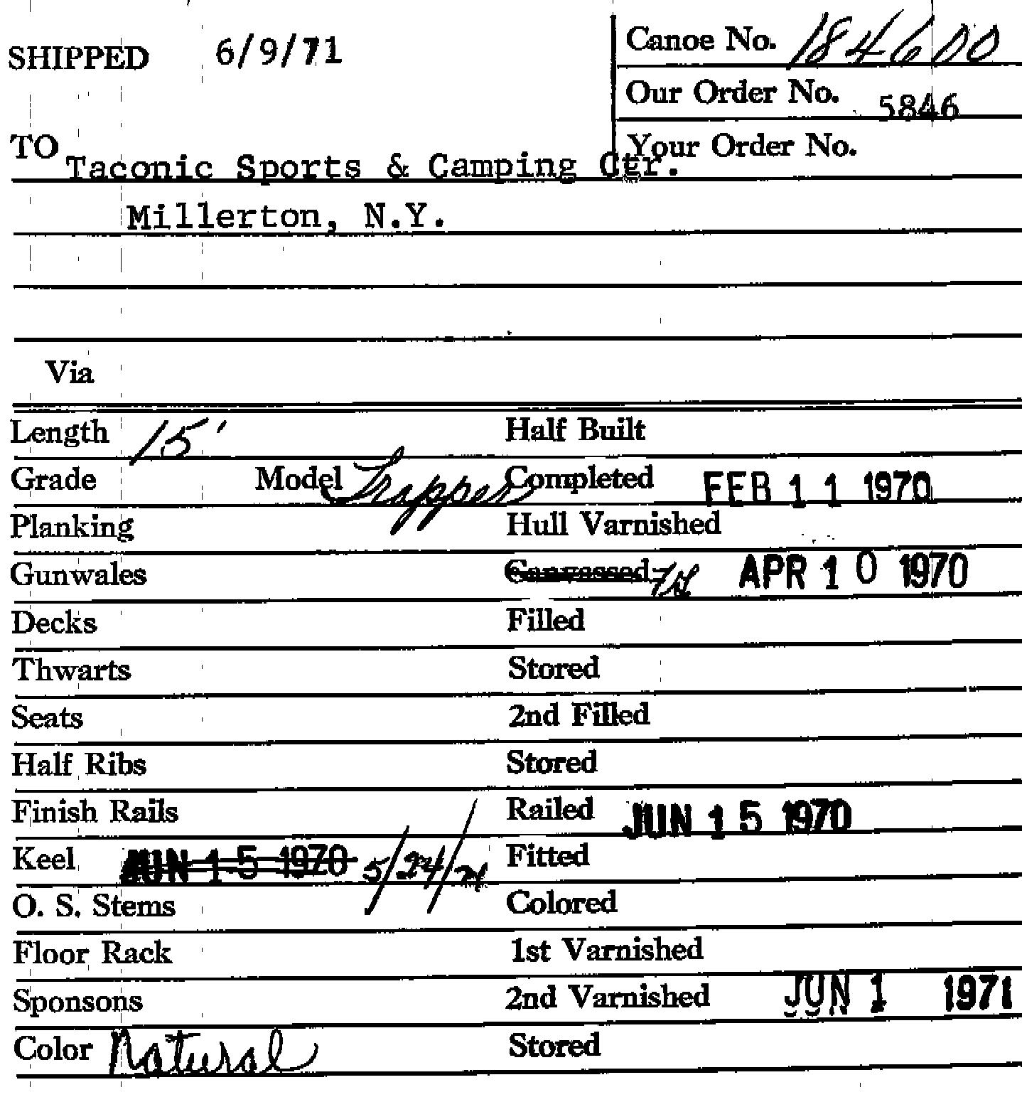

Nice call snubber, you know your canoes. Here is the reply I got from the Benson Gray of the Wooden Canoe Heritage Assoc.
The Old Town with serial number 184600 is a 15 foot long Trapper model with a keel. It was built in between February, 1970 and June, 1971. The original fiberglass exterior was clear to show the natural wood. It shipped on June 9th, 1971 to Millerton, New York. A scan showing this build record can be found by following the link at the thumbnail image attached below.
attachment.php
