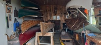

Things were going well, I managed to bend 6 new ribs without breaking any (post 61 of this thread), but in the end, installing them turned out to be more than I'm capable of anymore. Nailing in ribs requires one to hold that 4lb clinching iron up underneath the overturned canoe while hammering tacks from up above on the outside. While I could still do it, the quality of work was sadly lacking. I had an idea this was coming, the tacks in my new planking were just as bad.
I called my friend at Georges River Canoe and he will do the ribs and a small amount of planking in June.
I will finish it with sanding, varnish, canvas and paint this summer.
In the meantime, I have two other canoes to work on. I bought that solo Swift Heron from Yellowcanoe and a Spirt II from PaddlinHal. Both will look somewhat different when done, with bodywork, paint, and trim work.
