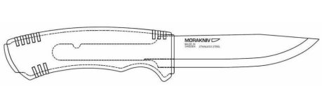

Like a number of other things, I have way too many knives, I'm guessing around three dozen, and that doesn't include kitchen knives. This is especially weird since I'm more of a scissors guy than a knife guy. At home, about the only thing I use a knife for is opening boxes and cutting meat. I've been using the excuse that I'm a knife "collector".
I've bought a lot of knives from the Knife Center. When shopping, I'll often use the "sorting" drop down menu and choose to sort by lowest price to highest price. I'm a bargain hunter. Among the fixed blades, Mora Knives (Morakniv) are often the cheapest or close to it. I always thought they were too cheap. I figured they can't be very good, even though they get good reviews. I also thought they looked too basic, maybe even cheap.
I plan on taking an active roll in the fire building, on club trips. For this reason I've been taking a closer look at bushcraft knives and the Mora name kept coming up.
So, I bought two and have another one coming. One is never enough for me. I have to say I think I was wrong about Mora. Yes, they are pretty work knife looking, maybe something you'd see at a job site, but the quality seems to be there and they are quite comfortable in the hand. Their cheapest models are in the $10 to $12 range. Can't get much cheaper than that. Even their larger, heavy duty models are around $20 to $25. I challenge you to find a better fixed blade knife for less money.
Maybe not the best for slicing cheese or a tomato, but for other tasks, around camp, they are as functional as knives costing several times as much.
Take a look at them, next time you are looking for a fixed blade.
