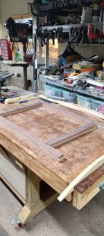

I am building a seat for a canoe I'm getting ready to start building. I'm thinking about building the Raven. I want a solo canoe and this design has been highly spoken of.
I've cut out a rough idea on a scrap piece. Is the seat area to large? I figured 22" wide with a 2" drop. Just getting my ideas together.
Appreciate any advice.
I make my seats as wide as the canoe lets me, take the width at seat location and allow ~3" at each side for the connection (Hang or cleats). This leaves lots of adjust ability for trimming to fit.
Assuming that pic from scraps is just for the shape you are planing, you certainly don't want the seat cut that way ... your best bet is bending strips to that shape to avoid all of those grain transitions, which will create a series of weak points.
Also, if you drop the front ~2" and then drop the back about 1" you create a natural cant forward, which helps get rid of that seat ridge that flat seats create on the back of your legs when you stretch out your legs.

Thanks Brian. I'm wanting to build the Raven by John Winters. The max width states 32.25". I haven't ordered the plans yet, but I think the 22" curve should be good, and leave at least 5" on each side for hanging and adjusting. So the front of the seat being dropped an inch more then the back is more comfortable? I don't kneel unless I encounter rough water. I've never steam bent wood before either. That'll be a new endeavor. I was going to laminate some cherry and black walnut for my seat frame.
Thank you

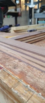

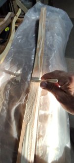

Got my walnut and cherry strips cut. The walnut I cut to 1/8" x 1 1/2". The cherry strips are 1/4" by 1 1/2". Cherry seems to bend better then black walnut. I need to make my bending jig, another thing I've never done.

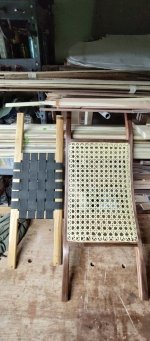

I'm hoping the cantered seat will be easier on my knees. I've made 4 seats so far. They were all flat seats.IMG_20230415_174048802_HDR.jpg
This is the black walnut seat in my Wabnaki. I weaved them a plastic cane looking stuff. Very little to no stretch. I wonder if natural cane would be more comfortable.

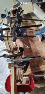

RB ... another point to think about for your intended shape, if you try to make that sharp bend at each side with 1/4" strips, your chance of a bending failure (cracking the strip) will be quite high. Thinner strips may be something to consider.
Jumped in and took a dive at it. VID_20230523_160446726_exported_7488.jpg 1st time steaming anything. IMG_20230524_161647856_HDR.jpg I couldn't find my other half of my make shift form, so I just started throwing the clamps to the part I had. I'll do better next time and have a better form. One rung at a time.IMG_20230523_192147983.jpgSlathered the glue on and then about 20 more clampsIMG_20230523_195107480_HDR.jpgIMG_20230525_130505664_HDR.jpgIMG_20230525_130505664_HDR.jpgIMG_20230525_130436190_HDR.jpgI had a little side slide with the glue strips, but it was manageable. I think it'll work. Maybe 1 and 3/4 inch drop. If it doesn't work out it was a fun learning experience.

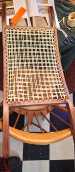

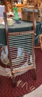

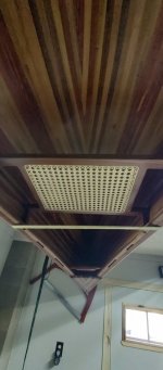

It has been raining here all day, so it was a good day to finish the seat.IMG_20230528_101628004_HDR.jpg
Not my best weaving job, but I'm happy with it. Going to put this one on my Mohawk solo 13. I'll make another one when I finish building the Raven canoe. This is fun stuff😊. I'm tired right now.
Roy
The seat didn't break, and is comfortable. I do need to raise it a little and raise the back side more then the front. I maybe could've bolted it to the gunnels, but I set it on the original aluminum brackets.IMG_20230529_104358516_HDR.jpgStock seat on the left.IMG_20230602_071627362_HDR.jpg
Very happy with the results. Thank you all for your advice and input.
