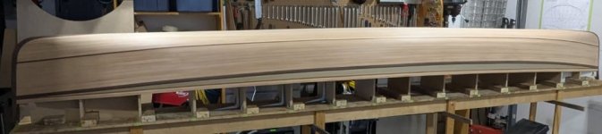

Fillet joint and filling in some gaps. Straight wood flour on the epoxy fillet but a mix of wood flour and walnut sawdust to try to get the colour right for the rest. Used one of those new disposable wooden spoons to round the fillet corner.
Shaved the epoxy down with the scraper then went over everything again with 180 grit.

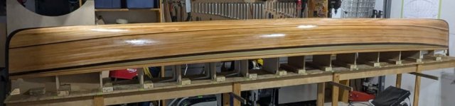

Vacuumed the hull twice then hit it with the tack cloth before seal coating. I really enjoyed the colour reveal.

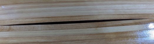

When the epoxy went on I saw a couple of spots I'll have to sand again. I didn't sand it enough the first time and the glue prevented the epoxy from soaking in.
I was happy with how the filler I mixed up turned out colour wise. It's hard to see unless you look really close.
I forgot to add, when I seal coated I did my best to brush on a very thin even coat tipping back into the wet. You could really see the sections where it sucked up the epoxy (flat spots) and the areas where it didn't (shiny). Hopefully it saves some weight.

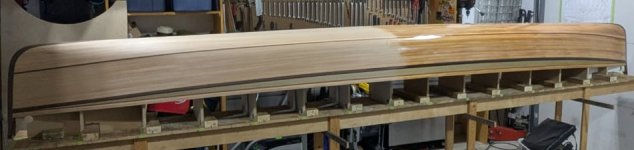

I tried scraping at the seal coat for a few hours the other day. It certainly allows you to take it right down. I put in a new blade in my scraper and it did well shaving. I ended up stopping after just doing the bottom bit on one side. Might have been user error but I ended up hitting wood in a few spots on the rounded bits. I also left a good gouge where I made some spots that weren't level from the random orbital. The long board worked so well I can't believe I've gotten by this long without one. I'm sure I removed more material with the scraping but I prefer the long board. In the first pic you can see the left side sanded and the right side scraped. I got most of the hull done today and was able to clean up the big gouge I made. I'll get the bow and stern sections with the random orbital as the long board doesn't work great there. I still need to get to the tumblehome sections. Still hoping for the 14th for glass.
