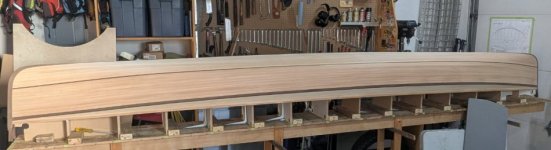

Well as the seasons change here I haven't had a lot of time for the boat. Just a little bit here and there. I got out for one last ride on the dual sport and got the house ready for winter. I've added to the stern laminations, they're bent, dried and ready for epoxy. I spent some time at it today and finished planking the hull. I decided to use a sliver of walnut for the whiskey strip since it was nicely centered. I over sanded one side and will have to glue in a shaving to hide it.

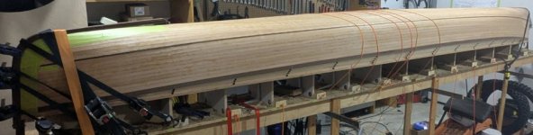

I got the stern laminations on using every ratchet strap I have. I used wax paper to keep from ruining the straps. It really helped to alternate the ratchets to keep the stack from shifting to one side. I'm pretty happy with how they turned out.
While I'm saving the tumblehome section sanding for last I made a pass over the rest (except the stern) with some 80 grit Abranet on the long board. I'm pretty impressed with how long this stuff last. I did uncover some dents here and there. Hopefully a little water will help raise them.

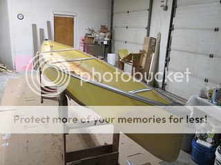

composite gunnels
Here's a better picture that shows the two together. I assume these are made by Clipper as they are what came on my Caribou S. These are available at a few shops in Western Canada. My Caribou has vinyl covers over them but I don't want the extra weight. I also bought the thwart material, end caps, seat hanger and seat from them. They slip over the hull and are riveted. The wide side goes to the inside and the thwarts are riveted up from the bottom.

I roughly shaved down the stern stem with the RO sander with some 60 grit. After doing so I could see I was a hair thin on making the curve look right. I epoxied on a few more laminations the shaved it down and shaped it some as I finished rough sanding the hull. I've still left it proud for final shaping. I will be leaving it a little high though Memaquay. From the end the stem's certainly not as uniform as I would have hoped.
When I sanded the keel line I was careful to approach it from one side then the other. Try not erase any center line by sanding it away.
I have no gas after being sick. Using the long board I tire out quite quickly. I pulled out all the picture hanging nails on the tumblehome section and used some 80 grit Abranet to level the walnut accent strip and rough sand the yellow cedar. I managed to get one side done over the course of the day before quitting early. I'm not minding the yellow cedar as much now.

I spent some more time sanding on the tumblehome section with the longboard. I offset the sandpaper a little to not chew into the piece below it. I also used the longboard to round over the walnut so the glass will lay better. I then used the random orbital and made 2 passes with 180 grit. I have the stems mostly shaped now and will just do some touch ups by hand for the final bit until they look right.
