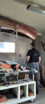

You can't see it, but my pack canoe is off to the far right, in the near garage bay, same pulley system, but upside down. I ran a couple pieces of large PVC pipe through the straps, and it's far easier to get in/out that way.
The pulleys run about $30 on Amazon, and are held into the rafters with 3" decking screws for the pack canoe, or 5" self-tapping something or other fasteners that go in with a hex driver... essentially a longer, slightly thicker deck screw.

I got about the smallest 2-car garage you can have. I used T-slot aluminum channel suspended from the ceiling. A threaded knob is removed and the bottom bar swings down. Canoe is raised/lowered via a rope and pulley system.
