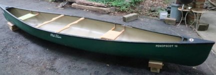

This is what it looks like; haven't touched it yet other than to bring it home and put it in the garage.
HIN XTC80619H102 - Manufactured August 2001 for Model Year 2002?
Ad picture 1. Port gunwale repair visble.

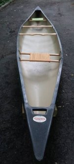

Ad picture 2: Hull twist and misshapen gunwales easily visible, seats wrapped in rope. Second portage yoke as rear thwart... odd.
Honey, look what I bought!! (My wife does not understand...)
Inside is clean as a whistle. Rotted dowels and widened front hull obvious.

Welcome to the forum!
First off, the Penobscot 16 is one of my favorite royalex canoes and worth bringing back to usable shape.
I repaired one years ago that actually looked worse than that, other than your gunwales. Mine was only cracked on one side, and since the crack was only halfway through, I patched it with JB Weld on an experimental basis - and that actually held for as long as I had it, which was quite a while.
Mine had a spot on the floor that was bubbled up. Looked to me like someone left a puddle of acetone there long enough to do that damage. I ignored it, and it was never a problem. On yours, I would remove all those ugly patches and patch whatever needs patched with fiberglass and g-flex epoxy. You could either paint it afterwards or mix some pigment (I like to use graphite powder) into the epoxy for UV protection.
I would simply ignore the little dents and holes near the shear they will never be a problem. I deliberately drill holes in that area for floatation bag cages. The cordage doesn't plug those numerous holes, but I never give it another thought.
My Penobscot also was twisted like yours. Because the royalex was too old and "cured" (baked, actually ;) ) to correct that, I just lived with it. And ya know? It was a little annoying, but I never noticed it having a negative effect on paddling it. YMMV, but you might want to paddle it a bit before you get involved in trying to correct that. My expectation is that since all royalex canoes are now too old to still be soft and somewhat pliable, I think it's unlikely that you will be able to change that much. I could be wrong, about that. But if you're lucky, maybe it will straighten out some with the gunwales replaced.
Since your seat hangers are shot anyway and will be replaced, I would make truss style hangers. That will be stronger and less squeaky. If the seat frames are still good, you have several options to bring them up to snuff. I like to use cordage for a Belgian chair weave. You can probably Google that.
That’s a very good deal, nice canoe.I prefer wood gunnels, lots of wood options and availability on places like Facebook marketplace and Craigslist. Those decks need to go…imho, haha Replace the rope with webbing on the seats.
I’m not sure about those patches, but GFlex is a great product.
Good luck with the resto, and please follow up with some pics and stories.
Good canoes deserve to be saved.
I would just live with the gunwales.
Perfect rock boat.
Welcome. I wouldn't have passed it up at that price either. As for repairs: I'd G-flex the one hole that looks like it went through (near waterline, not the bullet hole at the sheer), repair the seats and replace the gunwales. I wouldn't get real excited about the rest of the cosmetics.
From the upside down picture, it looks like the seat drops may be contributing to the seat being out of alignment so you may want to replace the drops with some that provide more stability. This would probably be easier with wood gunwales and you'd likely have a better chance of reshaping the hull with wood. (Besides, wood just looks better so unless you're a gram-weenie...)
Royalex boats tend to be heavy beasts so the weight of Ash or Mahogany might not be an issue but, if you did want to save a few ounces (and a few bucks) Yellow (aka Tulip) Poplar might be a good option for the trim. The color would complement the hull nicely and you can probably find a sawmill to cut full length boards and avoid scarf joints.
It's certainly no shame to paddle it pretty close to "as is" but, personally, I hope you try to pull it back to the original shape as I'm curious about methodology and what kind of result you can achieve.
