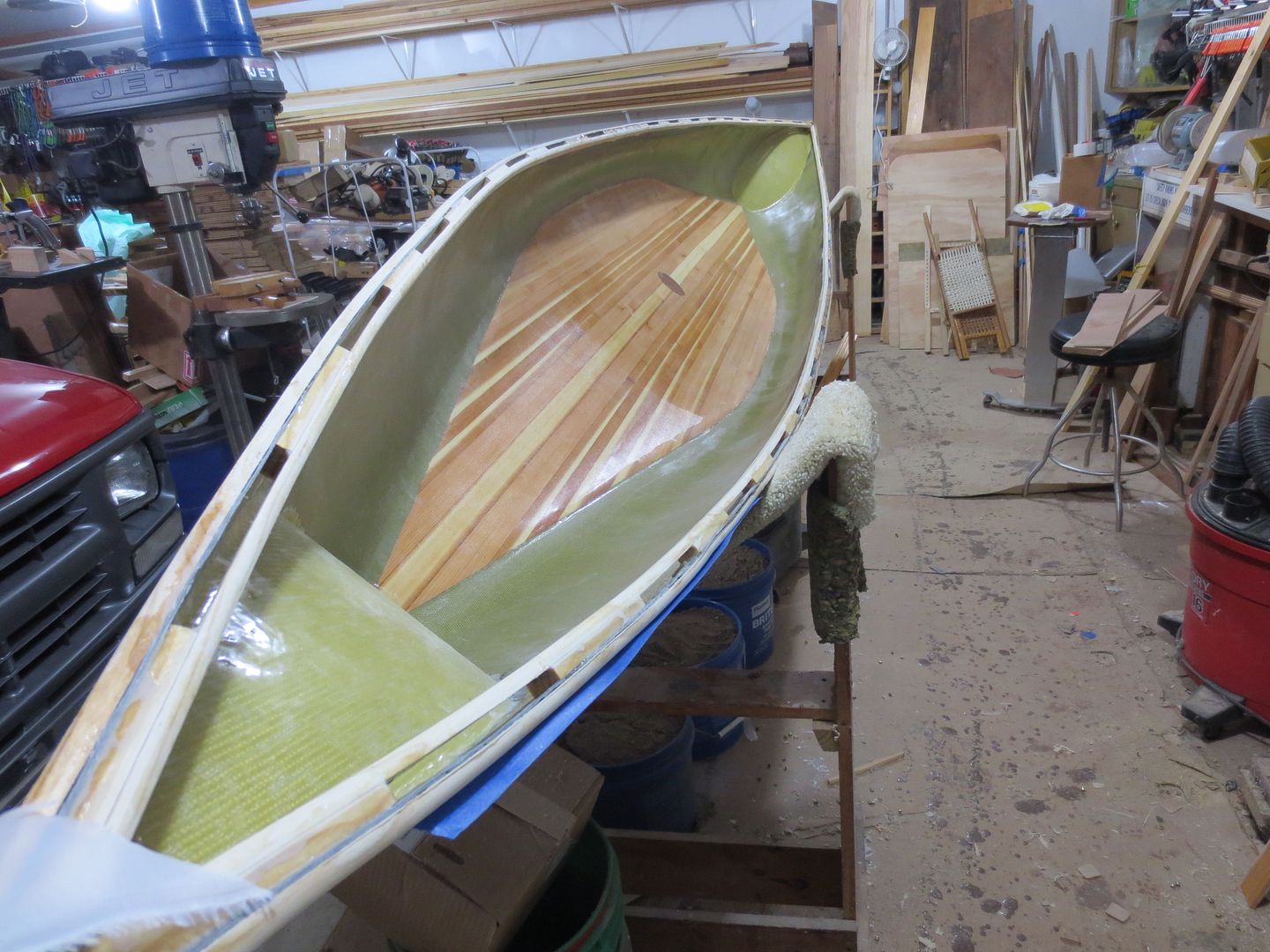

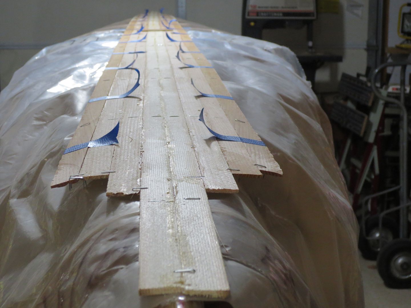

I'd recommend an insert for sure. I set up my forms and stripped up a cedar insert,1/8" thick. Pretty easy to do. No bead and cove, just edge glued the strips. Started at the center and worked out.
A layer of cloth was added on top of the insert to seal, and stiffen.
Stripperguy used a foam insert, and that might be a good route.
I am happy with the stiffness my cedar insert provided, as well as the weight.
Epoxied the insert to the hull with filled epoxy. I used sand to weigh the insert against the hull. BESURE to support the hull if you use my method !
I used about 150# of sand, spread out on plastic to do this, but if you can vacumm bag, that would work best in my opinion.
Stiffen the sidewalls ! I used extra layers of E-glass, in the center area. I wished I had used more, as I'm still not quite happy the sidewall stiffness.
Keep us posted ! You will love this hull when completed ! Especially when you portage !

My first composite, Oil cans terrible. It's stable, and reasonably fast. It still baffles me ! I used Pink Foam, and a layer of 6 oz E-glass. Foam pretty much delaminated, and did nothing but add a very small amount of flotation.
If you can afford, some proper foam, and cover with S-glass, cover the football with foam, and extra layers of S-glass up the sides, around where the seat is. That would be good,
Or as I did, and will do again, set up your forms, and make a cedar insert, with 1/8" + strips. Edge glue, cut to shape, insert, and apply a layer of glass.
Whether you use foam, or a cedar core, bevel the edges, so the cloth lays smoothly.

Update. I did something a little different for stiffening the bottom and added some steambent 1/4 inch thick walnut partial ribs. Covered with 2 layers of 6 oz fiberglass tape. Also added waterproof dry storage hatches to each end.
