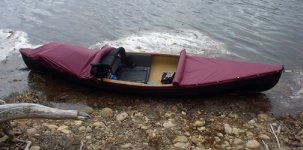

Blackhawks were great in wind with the shallow vee keeping the keel in the water. I had an SS Special that was rated to carry like 350 or 360 I think. It would have been a good choice for you in wind. I'll find a pic.
