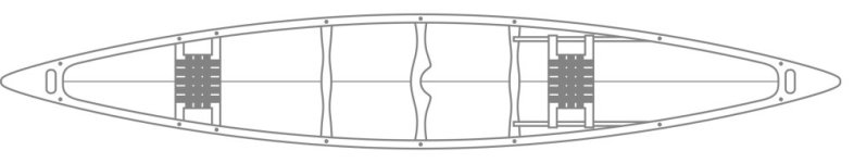

In the school I was talking to I've seen lots of “Prospector” from both brands but it looks like a canoe ideal for rivers but not for open waters (lakes in my area are subject to sudden winds) and this kind of boats could not be ideal.
I’m looking for a canoe that could be paddled both solo or tandem (especially tandem + little child), mostly for lakes but occasionally in rivers up to class II (no white water).
They suggested me to consider a length of 16’ especially Huron and Avalon from Esquif but reading some reviews seems also NovaCraft Pal could be a good idea (albeit much more expensive).
Making a little travel in France or Germany I could also consider other brands like Gatz, Armerlite or evenLinder's aluminum canoe.

Since your sources seem limited to Nova Craft and Esquif, I will give you some thoughts about them.
A symmetrical 16' canoe is a very good length for a tandem canoe that can also be used as a solo by sitting in the bow seat backwards. It can also be paddled frontwards as a solo if you install a kneeling thwart close to the center thwart or if you remove the center thwart and replace it with a wide middle seat placed about 6"-8" behind center.
The classic Prospector design is highly rockered, so it will not be as efficient a canoe on lakes as a less rockered canoe. It will be better on whitewater rivers.
The Pal is a classic design that can be paddled more efficiently on lakes than a Prospector design and can also handle easy whitewater rivers. Because it is a symmetrical canoe, it can be paddled tandem or solo sitting backwards on the bow seat. It was the canoe most used by the famous Canadian canoe teacher and videographer Bill Mason, who made many videos such as this introductory one:
https://www.nfb.ca/film/path_of_the_paddle_solo_basic/
The Nova Craft Pal should meet your needs nicely.
As to Esquif, I don't have personal experience, but I can tell some things from the specifications on the Esquif website. The Huron has exactly the same highly rockered hull shape (2.75") as the Esquif Prospector. All they have done is cut down the depth of the Prospector by two inches to make the Huron. So, the Huron would have similar paddling characteristics on lakes as the Prospector, but would be slighly less subject to wind. The Pal would be the better lake canoe, in my opinion.
The Esquif Avalon is only slightly less rockered than the Huron and is very deep at 15", even deeper than the Prospector. Thus, it seems designed to carry heavy tripping loads. I would still suspect the Pal to be be a more efficient lake canoe. Also possibly problematic with the Avalon is that it is made with a sliding bow seat.
The problem is that you could not sit backwards on such a sliding seat attached to a thwart for solo paddling. You would have to order the Avalon with a fixed bow seat and no front quarter thwart.
Of these three canoes, my opinion is that the Nova Craft Pal would best meet your stated needs for tandem canoe, which can also be paddled solo, to be used mostly on lakes but occasionally on rivers up to class 2. Other members here may have other opinions or actual experience with the Esquif canoes.
