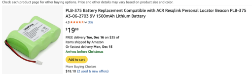

You don't need to send the unit back to ACR, there are other companies that also service the battery : https://www.liferaftstore.com/acr-battery-replacement-service
You can also replace it yourself if you are adventurous :
and get a new pack here : https://beaconbatteryreplacement.com/product/acr-plb-375-resqlink-battery/

I gave my ACR PLB-375 (now discontinued) with an outdated battery to a friend a few years ago. He replaced the battery with one he purchased on Amazon for about $20. He said it was a simple process and that he regularly conducts self-tests to ensure it functions properly. He was convinced that replacing the battery did not compromise the waterproofing, but keeps it in a waterproof case just in case.
