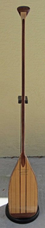

Currently working on an ultra-light FreeStyle Paddle. Paulownia and walnut.
In the 1st photo I am applying a sealer coat of epoxy to the sanded blade. In the second photo, a layer of 4 oz. fiberglass cloth has been applied. The weight of the clothespins help keep the cloth wrapped around the edges while the epoxy cures. On most fiberglass sheathed blades, that I have seen, the fiberglass does not wrap around the edges. This is just one small detail that sets Dogpaddles apart from the crowd. The blade will subsequently receive 2 additional coats of epoxy, before being sanded and varnished.IMG_1691 cr en sml.jpgIMG_1692 cr en sml.jpg

I'm shooting for 19 oz. It's a 38" shaft with a length overall of 58". I'll post the actual weight when finished.
