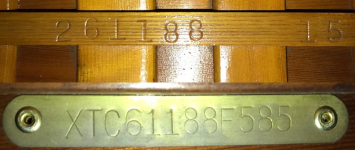

I was curious about the 390212 SN so I just checked the hull stamp. Between the XTC and the 90212 there in no "3" in evidence. I am not greatly familiar with the Old Town numbering system: would the "3" be an unstamped factory number or and error in stamping?
This is correct. The HIN format only permits five digits for the serial number so Old Town omits the most significant digit(s). This is most obvious in their wooden canoes which have the full six digit serial number on the stems and the five digit version on the HIN tag as shown below.
The full set of scanned records stop around 250000 in 1983 so there isn't an easy way to estimate how many Northern Light models were made in the 1990s.

I did not know about the hull number and the HIN being different on Old Town canoes due to the digit allocation. If I had thought about how many canoes Old Town has produced in it's long history I might have figured that out. Now I know.
