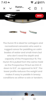

Depth is 12.5”?The specs on their website say depth is 14.5”.

As mentioned about Esquif's specs on this boat, there are inconsistencies on their site.

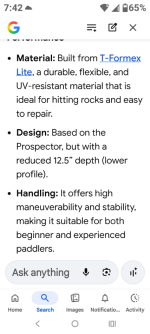

The depth is indeed 12.5" and my canoe weighs in at a tad over 49lbs. Could be 50lbs with scale varience but 49-51lbs would be a safe bet. Not a bad weight for a 15' canoe in T Formex Lite and a capacity of 750lbs. It is the same mold as the Prospecteur 15 but cut down to 12.5" depth to save weight and help with wind resistance.
Esquif needs to get their specs correct for sure! Since I live very close to a few big lakes, I chose the Huron for the shallower depth to help on windy days.
It is a solid canoe and is perfect for my uses.
