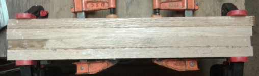

I'm going with an inner stem that follows the 1/2" beam line. I could build this up with a glue lam, either super-thin and dry bent or steam-bending some thicker layers. However, that's a pretty tight curve that wants a lot of meat behind it. Tentatively, I'm intending to build up in block fashion. Vertical stem posts, with a transition to the keel. (I'm sure that timber has a name. I don't know what it is.) Joint to the keel is a long bevel, at least 8:1, which should give me long-grain glue performance. The stem is let in with a bridle joint, so I've got flat-on-flat glue there as well.
Started laying up the blanks for the inner stems. The outer stems can wait - I've got options on how to handle them, and I haven't decided if they will be a simple taper, or more of a "cutwater" style.

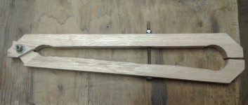

Also, one can never have too many clamps. What I currently lack are clamps that can reach deep, but don't have to grab all that tightly. Found This "Instructables" listing and thought it would be worth a try. Note that some of the instructions are a bit muddled when it comes to matching the halves of the hinge, and their way of making the jaws parallel was too backside-puckering for me. YMMV.
This turned out okay. I think that further ones will be a bit shorter with more meat left on the jaw arms. 7" reach should be plenty for this project.
