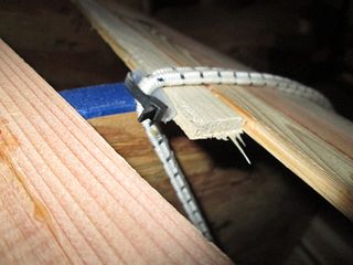

My last build saw (lengthened Kee 14 clone) the introduction of a new strip hold down system, the Jimmi clamps ... time to replace that shock cord and maybe try some stretchy belt style hold downs for snugging to the form
I used gray latex exercise/physiotherapy (Theraband) material ... it worked just OK, but there just wasn't the strip alignment I had with the other systems, it was a bit of a struggle. Enough so that I won't use it on this build and would classify this as a failure in performance, success in ease of use. The Jimmi clamps are a keeper though.
The trick here is to figure out the "why" of the hold down systems success and failures. All of the original hold down methods were successful performers, but had issues with use/waste and had a couple of things in common.
They looped from the sheer to the strip edge, creating a "inward pull" towards the canoe inside and the strap kept the strips held to the form. Sort of like this crude drawing, hopefully you get the idea
The strips usually twist on their journey from bow to stern, the leading edge then tends to flex up ... the one big change here was the introduction of the Jimmi Clamp, it excels at pulling the strips together but it eliminates that inward pull. That means the only thing holding the strips to the form and trying to keep them unflexed is whatever strap mechanism you have. The strap is exerting force in the wrong direction to effectively counter the strip flexing, hence the issue keeping the strips laying flat to the form.
This outlines some history and what the hold down system needs to over come in a stapleless build and that the goal you are chasing is something that works and is easy to use with minimal waste .... so on to the next part of stripping.

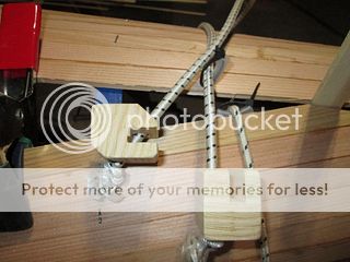

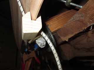

Your strip clamping method is pretty elaborate, but effective.
These bungee cord straps are the Brain Child, of another Jim Dodd .
They work great.
Both wood blocks hook on the Shear strip, the one with the slanted hole drilled in it, is adjustable, and looks by friction. So Quick and easy to use !
Zip tying 1/4" plastic tubing to the Jimmie clamps and the Bungee clamps helps protect the Fragile Cove lips.

The new hold down system is actually worth the effort for me, it is hands down the easiest I have tried and it worked well (with no mods) right up till I closed the football.

I've been giving my Jimmie clamps a work out , with my new build.
They are so handy ! They are like an extra helper, when it comes getting Beaded strips in the coves.
I need to replace some of the inner tubes, on my clamps, as they are showing their age.
I found leaving the original plastic tips on the clamps, helps hold the tubing in place, and is softer on the hull strips.
Bungees are a great way to hold strips in place. Buying a roll of Bungee cord is cheap, and making your own holding devices is the way to go.
