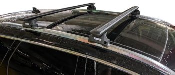

I just got a new car (Hyundai venue), and am looking to buy a rack that can hold two canoes. Does anyone know of a telescoping rack?
I have a Thule rack on my Outback and bought the 76" bars separately. They work in same towers and are pretty easy to change.
You can find a lot of roof racks at etrailer.com. Just figure out how long.

Yakima has a 78 inch round bar for their towers and factory rack attachments. Carries two tandems pretty well. I highly recommend gunwale brackets for any brand you chose. They really help stabilize the boats, especially if you are dealing with factory attachment sites that are only two feet apart. I carry two tandems at interstate speeds on an old Honda CRV with no issues.
