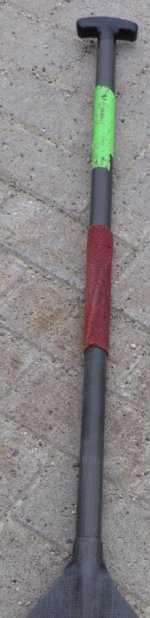

When I bought my first carbon paddle in 2014 I used it for a 750km trip, by the end of the trip there was a distinct groove in the shaft from all the prying off the vinyl gunnels. I added whipping using 2mm nylon cord which eliminated the issue and it is still as tightly wound today as it was when first added with no further deterioration of the shaft.
The pics at that link show a very long section of whipping, on my paddle it's just long enough for my grip plus a little more to ensure it's the only part of the paddle shaft that ever contacts the gunnel.
