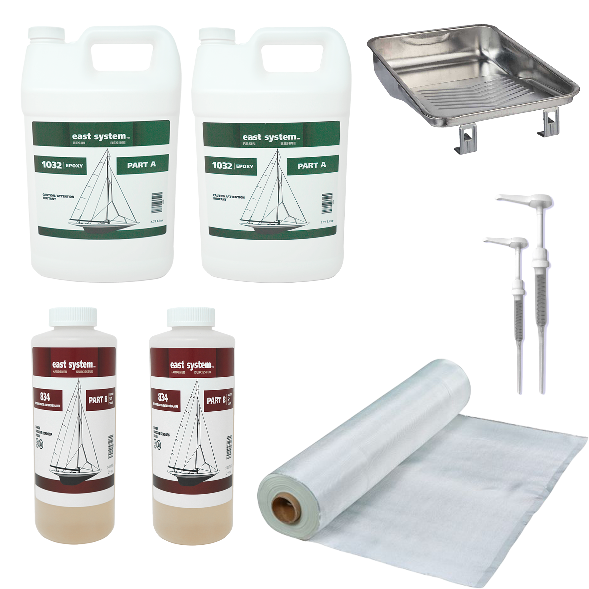

Anyone buy any epoxy and glass in the States lately? Got a quote from one of my Canadian suppliers to day, it was twice the cost from 2019. Usually glass, epoxy, taxes and shipping for a canoe the size of the raven comes in under 500 Canadian loonies. Quote from today was $975. Still waiting on another quote, hope it's better!
Try a canoe covering kit from Noah's using East Epoxy, that is about the most effective cost wise that I have found on Canada
Thanks Cruiser, I have been in contact with Noahs and Composite Canada. Then I just happened to check Amazon....they sell system three silver tip and e glass too. Shipping on the silver tip was only 15 bucks, 20 yards of 50 inch e glass shipping was free. So done deal, now I can stop obsessing and get back to work, lol.
