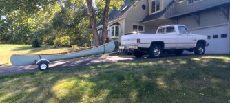

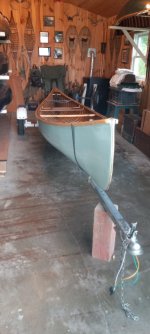

Getting my wood canvas canoes up on my trucks roof racks is still doable but getting harder each spring so I found this on Face Book Marketplace Monday. It needs some work but it was pretty much what I was looking for. Lights inop, fender bracket weld broken, 1” &7/8” tongue (2” ball is my go to) and it’s stretched too long. All easy repairs or adjustments. Actually only used once per the po.
With no suspension to deaden the road bumps I plan to build up the bunks with foam pipe insulation.
