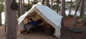

I use a downsized canvas wall tent with an interior frame and a small no brand wood stove that I cut down. I have over 100 nights in it. Mine is capable of fitting 2 people on cots, but I have always gone solo. You can actually build your own wood stove, lots of plans out there..Just big enough to take the chill off evenings and morning, I sleep with a cold stove, I think most people who backcountry camp via canoe or sled sleep with a cold stove, it requires a lot of wood preparation and waking up hourly to keep these stoves hot all night.
A527D908-022A-4C91-A747-7C46BA7D373A_Original.jpeg20240905_062657_Original.jpeg8DDD70E4-161B-4002-B7A4-DAA0F99DA2AA_Original.jpeg932907EF-6F18-447F-847F-DDDA4C57AA1A_Original.jpegIMG_3401_Original.jpegDSC05436_zps8d55dbc7_Original.jpeg
