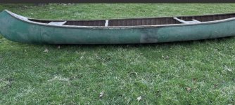

Greetings WC and B canoe folks-
I’m a new member… name is Drew (DT). I purchased my first WC canoe this past Tuesday. I was encouraged to post a thread to hopefully share and definitely get feedback and advice on this new endeavor. It is a 1940 OTC CS Yankee 16’. I spent last night poring over the This Old Canoe (thx Robin) and setting up my cradle. I am going to begin the investigation/ note taking part tonight and taking pictures before I do anything else. Oddly enjoy going into the shop and just admiring the beauty. Here is a picture or two and the manifest kindly provided by Benson at the Wood Canoe Society.
Cheers
DT

Love the build records..I am amazed that the boat was essentially off the form and canvassed in a day but the fillers needed a long time to cure before finishing off. Thanks for sharing, Drew.
Welcome to the w/c canoe club. I'm in the middle of my second w/c canoe restoration and I can affirm your notion of "admiring the beauty". I thoroughly enjoy spending time with the details of my canoes as well! I find it interesting that although most of the w/c canoes we might find were production built, it's impressive how finely detailed they are and so completely repairable.
Being a somewhat detailed note-taker myself, I also keep for future reference the old planking tacks, rib/inwale nails, and screws I remove for future reference if replacement hardware is required. It's easy to measure the old fasteners and hardware for replacement.
Here's mine currently... It needs two planks replaced, and I made them out of western red cedar; ripped from 1/2"x 8" bevel cedar siding. It'll yield at least two full length planks ripped to 7/32", then drum sanded to final thickness to match the existing planking.

I thought the record was interesting too… like looking back in time

Pat that looks awesome…funny you mention the production build, yet the detail orientation of the build…i thought it was ironic that with all that is out there in modern builds… these are still lasting and their life extended
thanks for the pics… it look great.. will be using that technique for the planks…thank you

Well… I cleaned the outside and inside … rinsed and began cleaning out the screw heads and removed the stem bands and port side outwale. Some of the tacks under the outwale were still bright and shiny. Others… not so much. I found one repair on the gunwale done with a steel screw. So far the wood under the first gunwale seems good. Did find two new areas in need of attention on the planking after cleaning the inside.

Here’s what she is starting to look like under the varnish… pretty exciting
