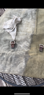

I am otter waxing the Duluth pack while I wait for the stripper to work… I have been using plastic pick tools to get some grit build up out of the bow. I believe I will be ready to wash this week and start on the inwales and decks with stripper, anyone know where to look for spruce stock to make up new outwales. I have a supply of Mahogany at my disposal, but would like to keep the weight down if possible… here is the pack as I apply heat to get the wax to soak in and the bow after some picking
