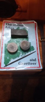

A little late but here's my stones. The one on the top is my kitchen "go to", the rounds are nice for my axes.
The narrow triangular on the bottom goes with me on trips, lightweight, nice for freshing up the knife and ax, plus small enough to
sharpen hooks when fishing.
