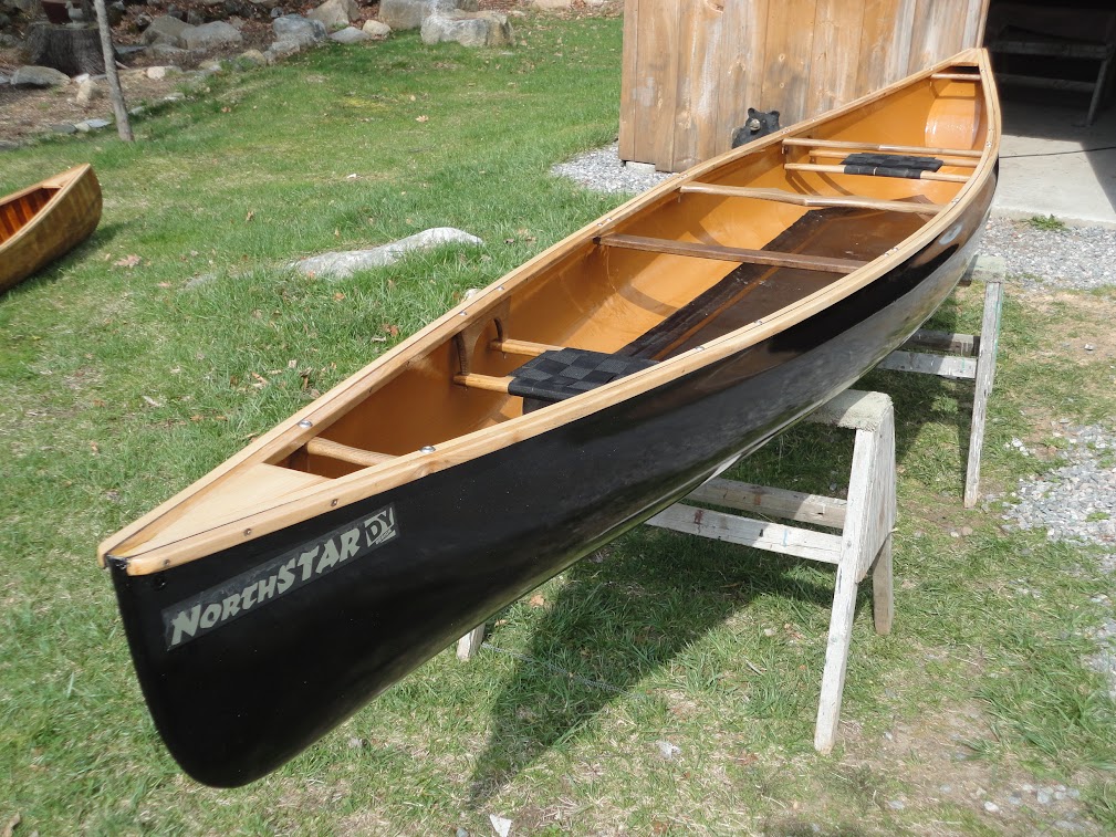

I picked up a Bell Northstar a few years ago, it was beat up pretty bad and the wood rotted. I managed to do some first time Kevlar repairs and the canoe turned out pretty good and I have never heard back from the buyer, actually he got a great canoe for cheap. Just adding my 2 cents, if the price is good it's worth a shot imo.

I didn't spend a lot of time on interior cosmetics, I gave the cracks some strong repairs and the new owner saved a ton to get a light weight Kevlar canoe

I sold that damaged Northstar in post 6 for maybe $700, maybe less, it's been a while. I paid $45 for it, drove 100 miles round trip, spent money on paint, ash lumber and G Flex not to mention the time working on it. If it was for personal use maybe a good deal, but no more kevlar hull repairs and try to resell it.
Just my experience, glad I'm a wood canvas guy, easy to get them looking like new.
