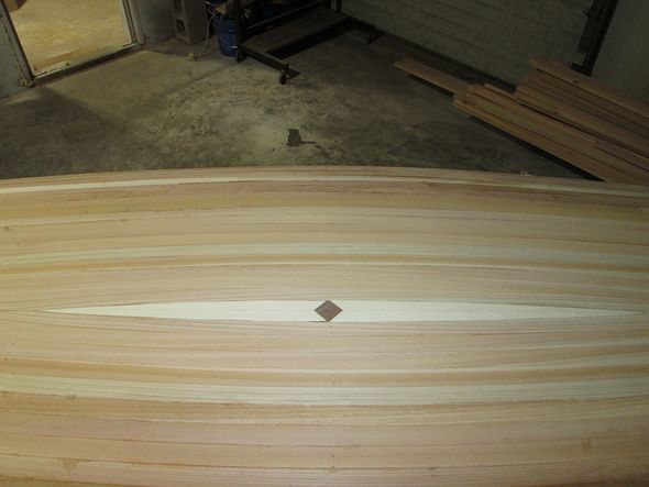

Well, hull is closed, staples are out. I've started sanding and found more issues...
In my quest to keep glue squeeze-out to a minimum, I believe that I was over-zealous. When pulling staples, I found a few areas where the strips pulled away from each other as the hull flexed. Upon inspection, I had very little glue in these areas.
I refilled the syringe, squirted what I thought should be an adequate amount of glue onto the high side of the seams
wrapped a strip in clear tape to keep from gluing it to the hull and stacked a few strips on top of it. I then put the ratchet strap over the strip stack & snugged it up, pulling the hull together
I allowed it to dry overnight and I am satisfied with the results.
I will be a little more liberal with my glue application on the next build, however, as it seems easier to rasp off a little extra squeeze-out than to realign and re-glue seams that didn't hold because I was too stingy.
At this point, I've rasped about 85% of the hull and sanded the same with 80 grit. If I seem to go from one extreme (barely sanded the Freedom at all) to the other (fairing this one by hand with a 17 inch long board), it's because I asked a friend (auto body technician) for advice.

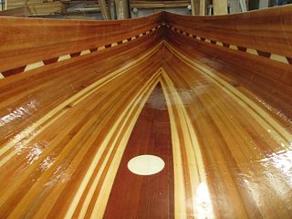

Looking good, and I like using a long board, I think it gives a better fairing. Although once I past 100 grit, i figure the actual material removal and fairing is finished ... I use an ROS for the final portion
For making it easier to install the Whiskey strip, I didn't strip all the way to the center on the first side. That way, I could easily fit the last few strips on both sides at once. I even made a great opportunity for an accent.
